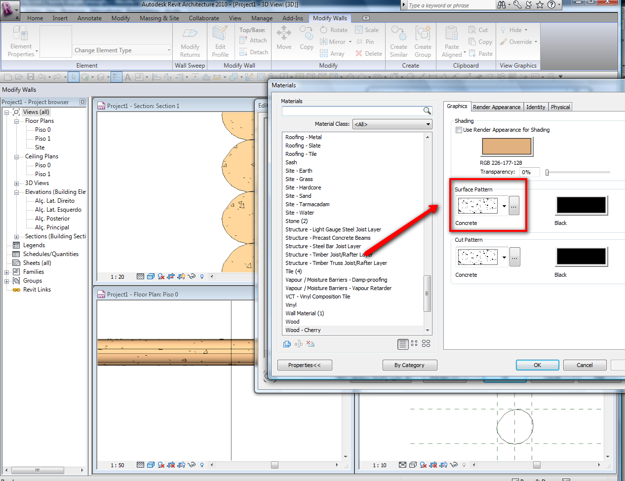

I want my concrete foundation walls to display with a concrete fill pattern regardless of whether the view range is cutting through the wall or not. I assumed I could just change the material fill pattern to the concrete fill for both cut and projection, but for some reason the walls still won't display the hatch. The coarse scale fill lpattern is concrete as well. Am I missing something? The hatch only displays when the wall is cut, but is blank otherwise. Any help is appreciated...
Thu, Jun 18, 2009 at 1:53:08 PM | Seems simple enough...
Coarse fill onlt applies to walls that are cut.  You can select yor walls and over-ride graphics in view adding a surface pattern and or fill color.

Did you select the hatch pattern to the "surface Pattern" OR only to "Cut Pattern"???

I selected the concrete fill for both surface pattern and cut. The override would work, but I would have to override every foundation wall, as the "by category" option includes every kind of wall. Plus I'm trying to set up a template file to avoid constant overrides.
