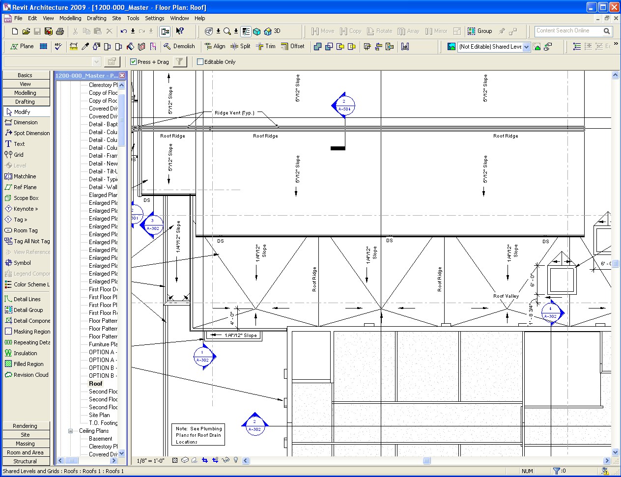

See the attached.
 I am doing an addition in the corner of two existing buildings.  The existing buildings have 3'-0" Overhangs.  I have hidden the roof of the existing building so that I can see the entire new roof below.
For a clean drawing I would like to draw a masking region over the existing buildings so that all I see is the outline of the existing building - you will notice that you can see walls because I have hidden the existing roof.  When I try and draw a masking region, it doesn't cover anything up.
My view is set to hidden line.
Please help!
 Thanks!
Thu, Jun 18, 2009 at 9:18:25 AM | Masking/Filled Region Does not work in Roof Plan
Masking regions work ... transparent filled regions would not work... but another way - just window cross the existing inside the exterior walls and right click - hide in view ... or you could be creative and do a plan region....
