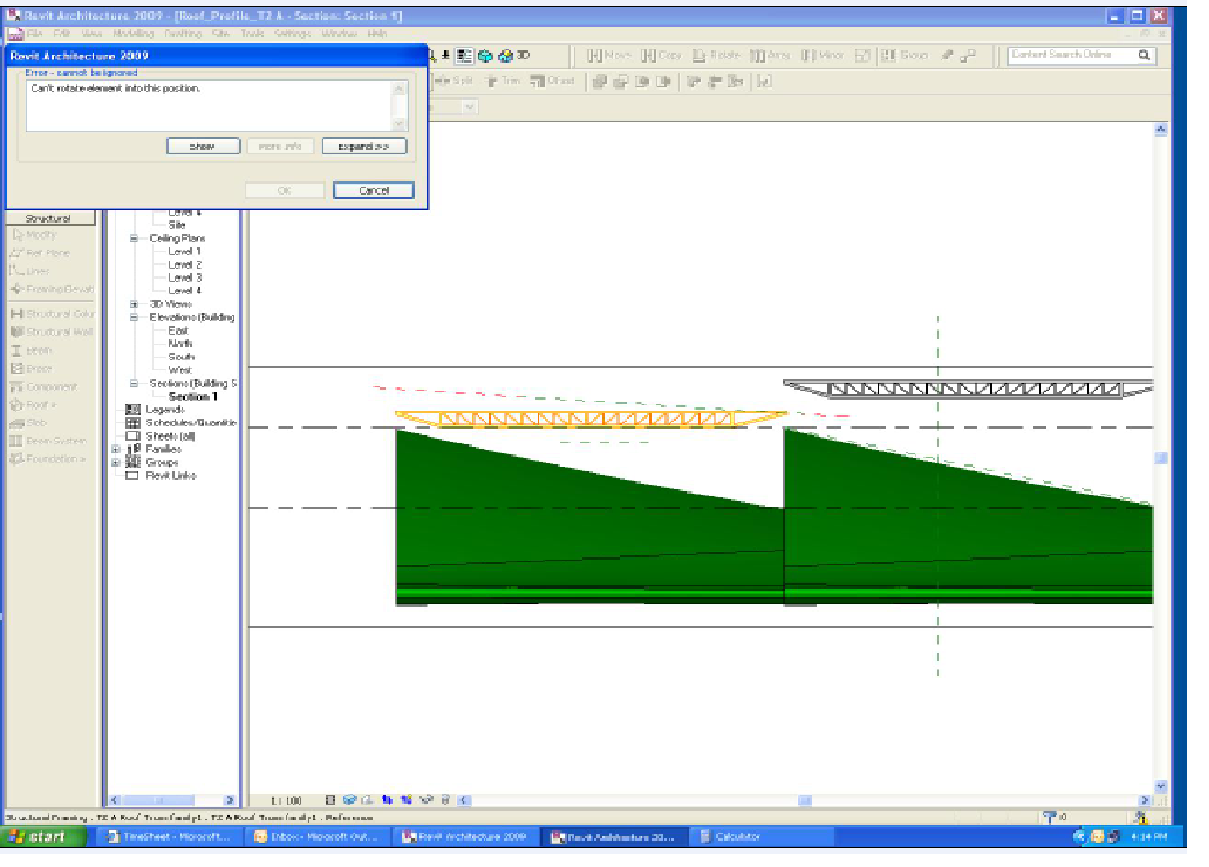

Hi,
I am trying to rotate the truss but it gives me error that "CANT ROTATE ELEMENT INTO THIS POSITION". Find attached the snapshot for more details.
I have created the truss thru solid modeling using family template - COMPLEX AND TRUSSES.RFT
Any suggestions
Now on the implementation stage....

I got the answer.....
Thnx everyone

I used BEAMS AND BRACES.RFT template instead of COMPLEX AND TRUSSES.RFT.
It works fine then....
