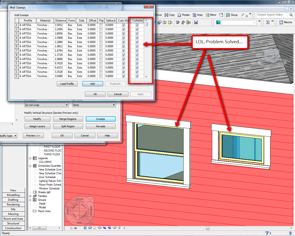

All right Typhoon I went in the wall properties and added sweeps to the wall with the siding profile.  Then duplicated the profile and changed the offset.  Looks great except that I just noticed for some reason it is showing through my windows at the top.  Ugh!  Any solutions?

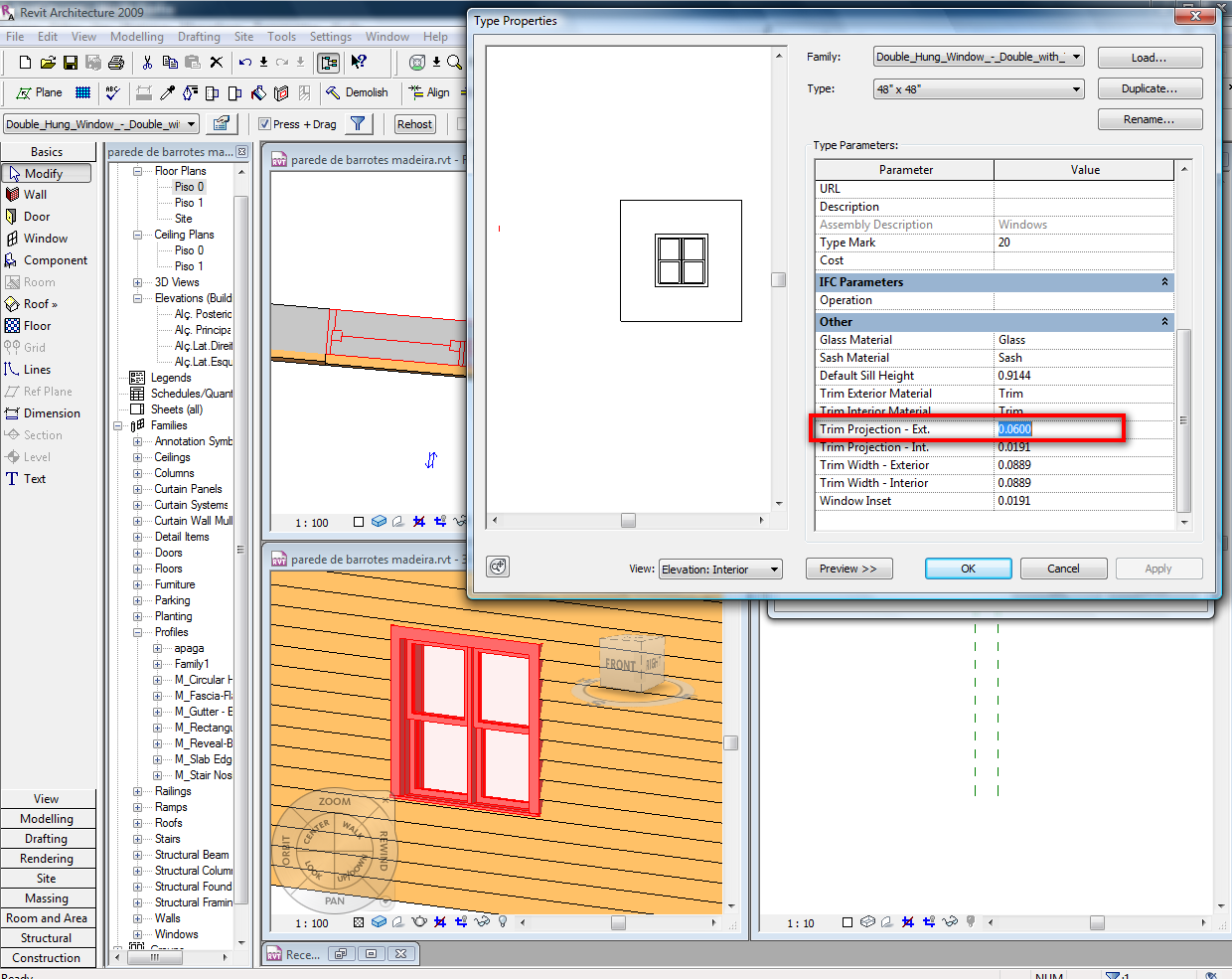

All right Raina, like you can see you can circumvent the situation with the properties of the window/door itself, "push" the window/door a little to exterior....
I hope this solve the issue....

LOL, Problem solved, Check on the "Cuttable" parameter...

Did the trick!  Thanks again!
