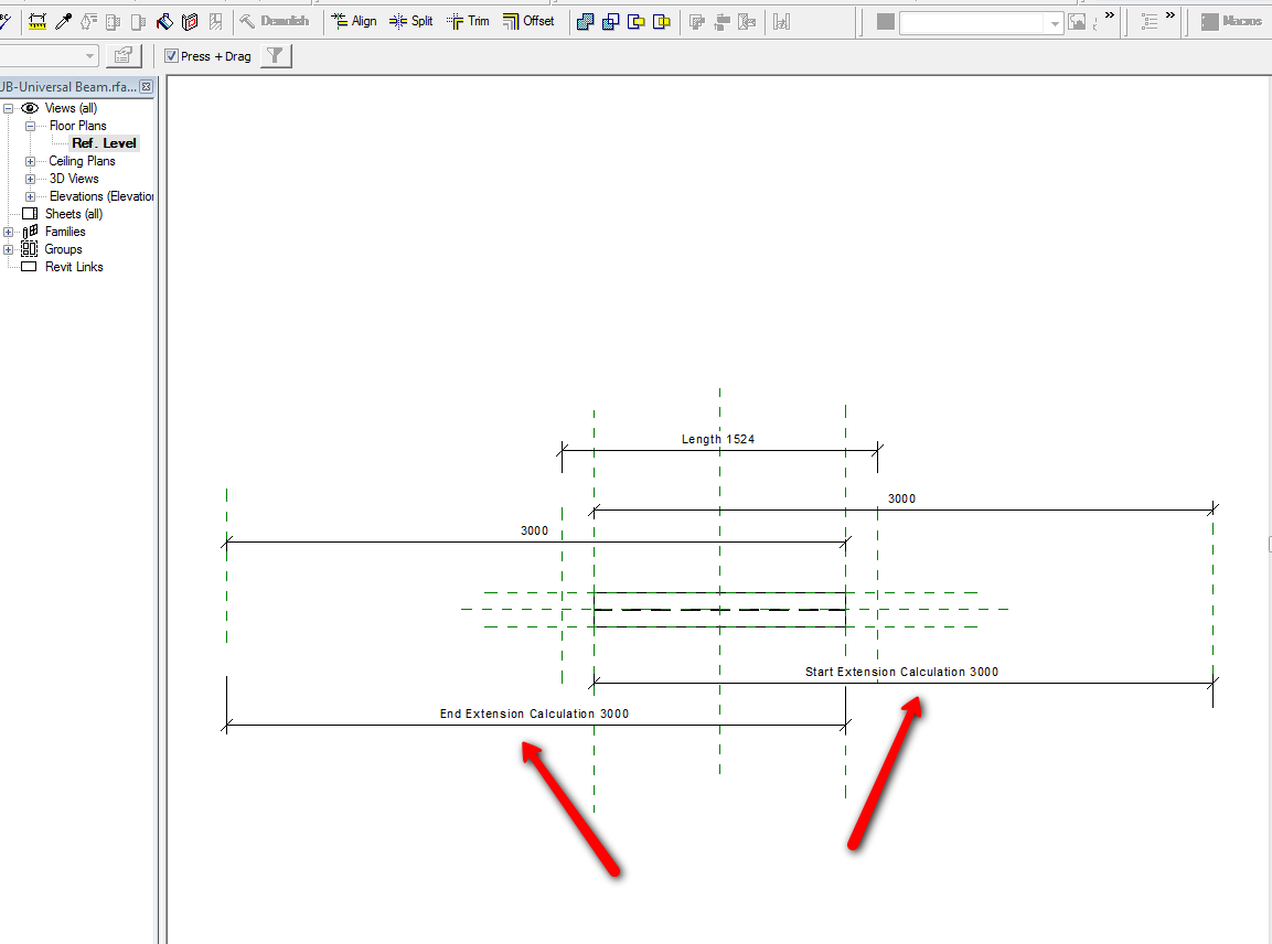

I’m still working with beams and I have a new problem..
There use to be a hidden 12.5 mm parameter somewhere and  then there use to be Start Extension and End Extension of 2.0 but on my beam these parameters are missing. How can I get them?
/Sanne

Check editing the family to see if the family has those parameters...
Tue, Jun 23, 2009 at 9:06:56 AM | Extension
sanne
Joined: Tue, Jun 16, 2009
19 Posts
It dosn't have those parameters..
Tue, Jun 23, 2009 at 9:34:32 AM | Extension
Joined: Tue, May 22, 2007
5921 Posts
4 Stars: 205 Votes
Well, create in the family those dimensions then go to add parameter and create them like you can see in the image i post before, i hope the beam is attached to ref. planes if not use the "align" tool to do that...
