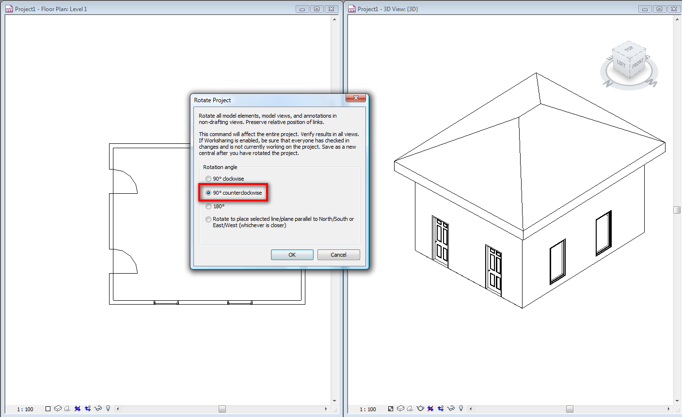

I have drawn my structure in such an orientation that the 'front' is what is referred to as "LEFT" in 3D View.
 The elevations are no problem since I can just rename them but I would really like 3D Front to be my notion of Front.
 Is there a way to either redefine Front in 3D View or to rotate my whole structure 90 degrees?

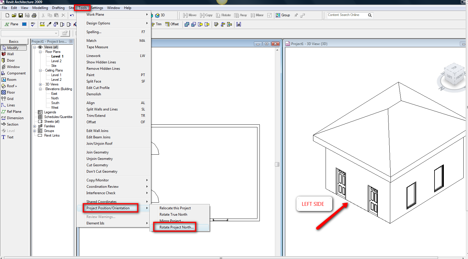

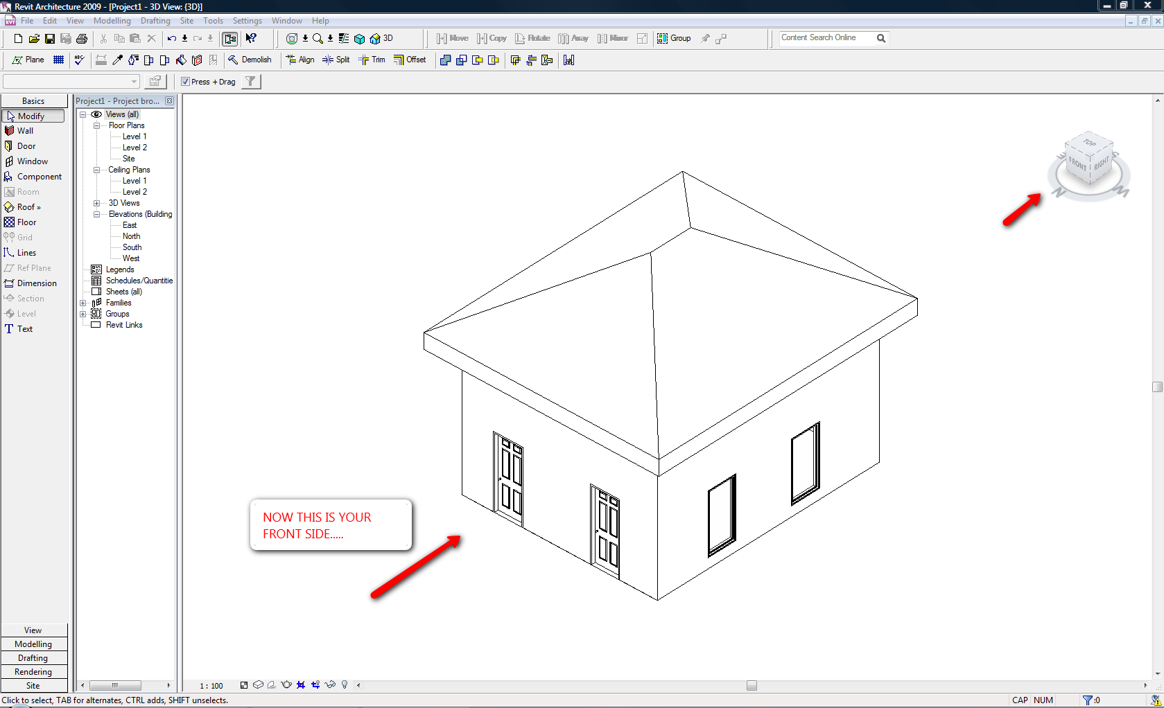

"Is there a way to either redefine Front in 3D View or to rotate my whole structure 90 degrees?". One way could be this: In a plan view go to Tools-->Project Position/Orientation-->Rotate Project North-->90° Counterclockwise.....

Thanks.  I did that and a bit of fiddling wth the "Project Base Point" in 3D view and I now seem to have something that makes sense.
