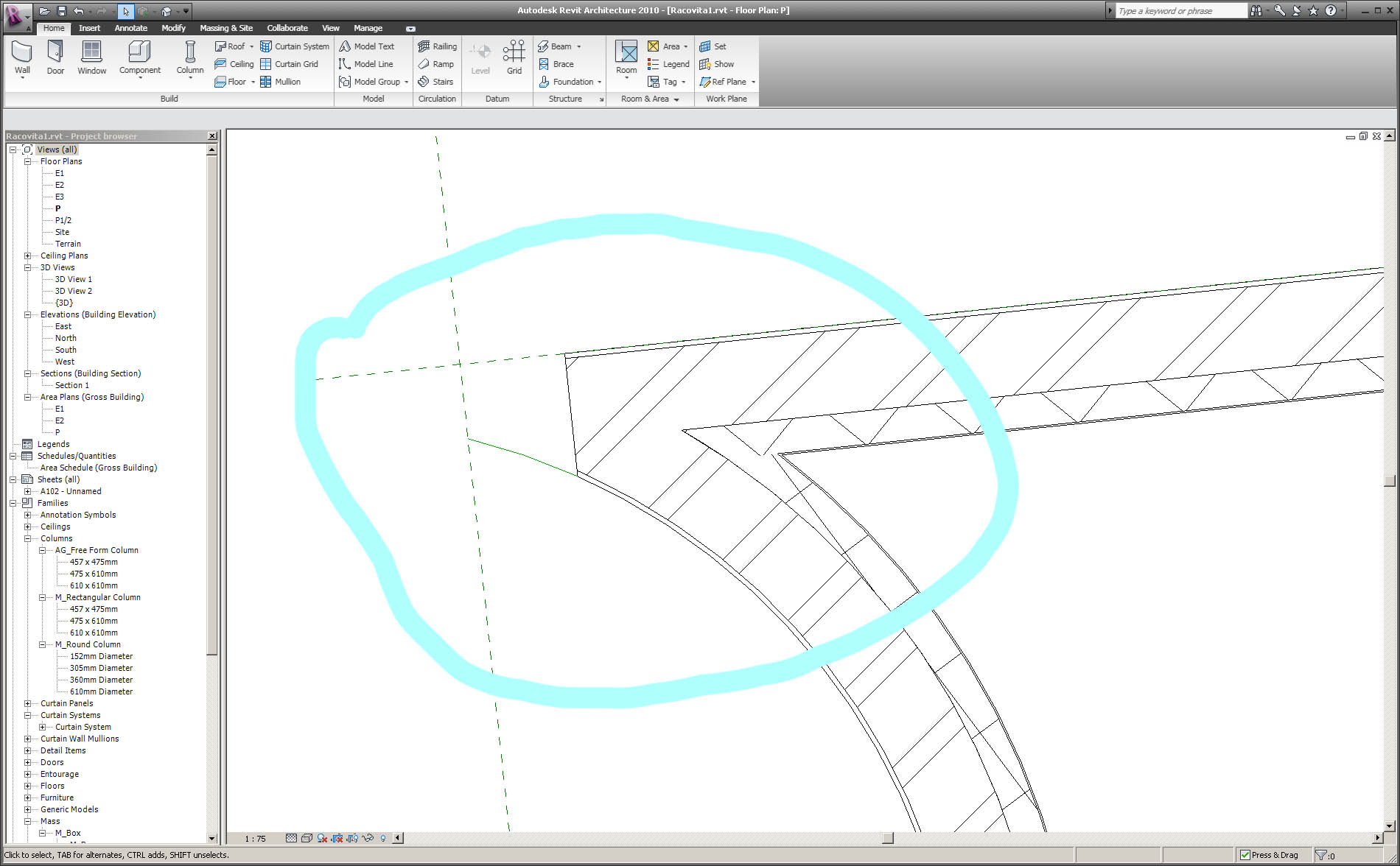

Hello all,
I'm a new Revit enthusiast after using Arch Desktop a lot.
I reckon Revit's advantages but sometimes I really miss some of the ACA's little&simple things that made custom design so easy to perform.
 Here's the current concern:
I couldn't get the walls from the attachment to join in the shape defined by the ref planes. I've tried the Arch Columns but didn't help.
How can I make something like a Wall Modifier (showing also in 3d) in Revit?
In ACA it was very easy, as I drawn the shape in plan than selected the component, then, here it is: a wall with a "sweep" in the shape I want...
Please, give me hope.
 Thank you!

What is the dimension of the short wall?
I can't see "Height" parameter value of Wall or Currtain Wall Schedule?
