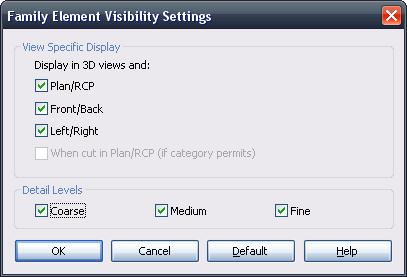

Edit the family, select the extrusion, click on 'Visibility'.
A menu pops up which should look similar to the attachment.
Make sure the 'Plan' view is checked and save the family.
If it still doesn't show up in plan views, you might need to add 'Symbolic Lines' in plan view of the family.
