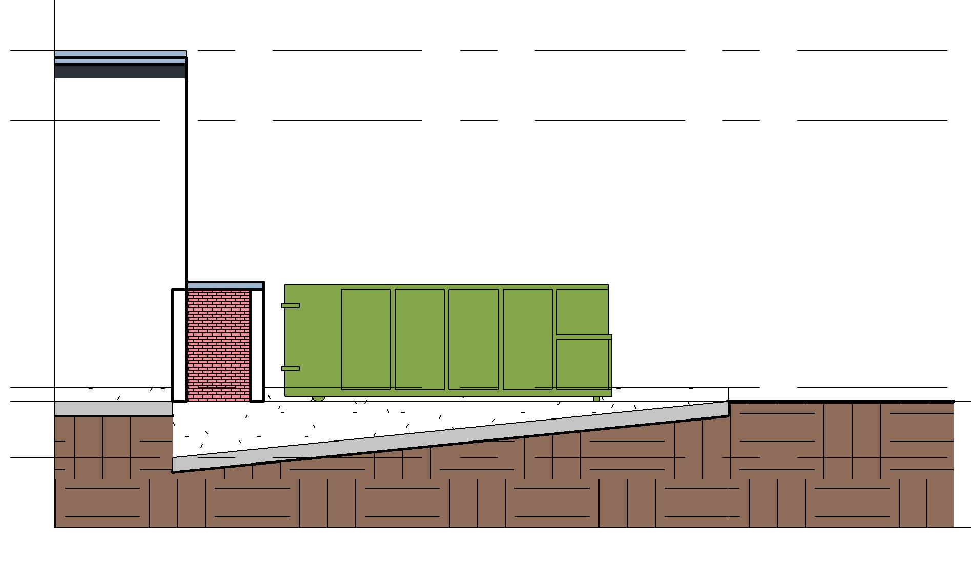

 I have aloading dock, sloped toward an exterior wall.  Question:  How do I get a dumpster and an 18-wheeler ON the slope?  There doesn't seem to be any offset for either end of the things, and I tried to rotate them in a section, but that doesn't work.  They look bizarre floating above the slope they're sopposed to be on.

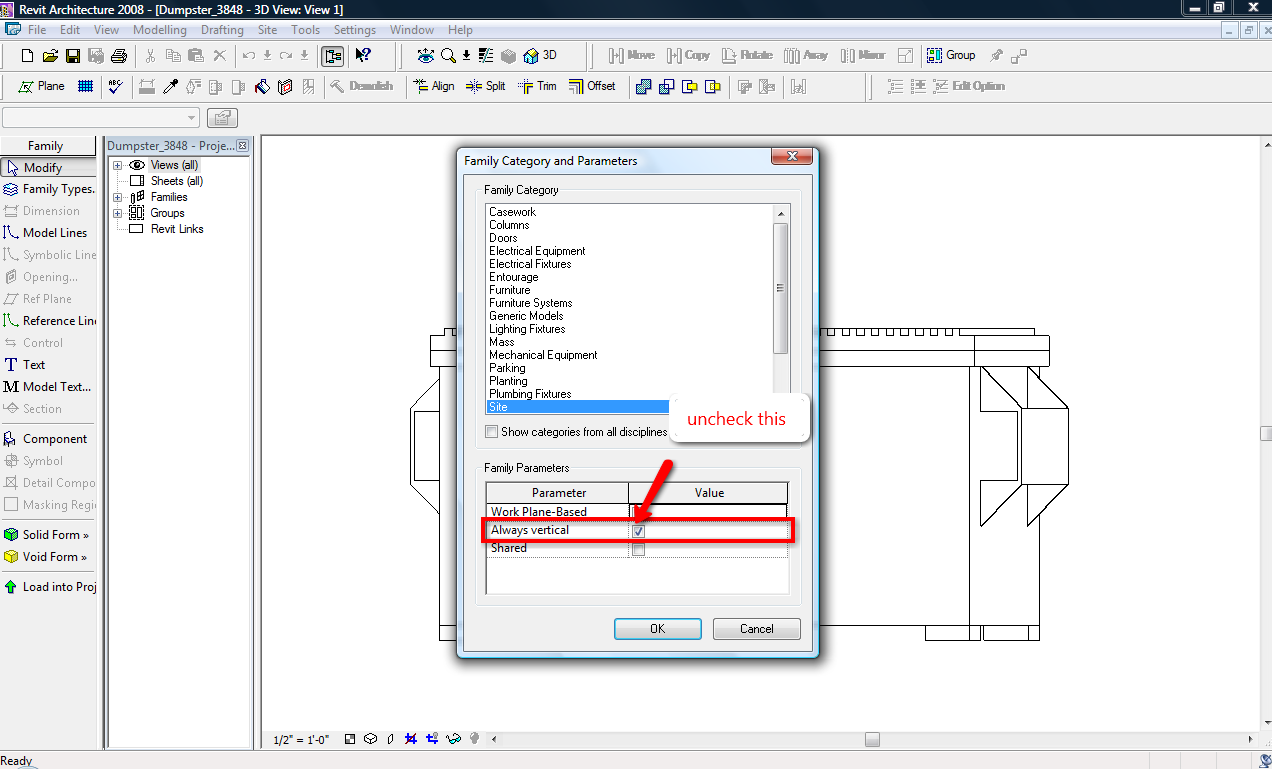

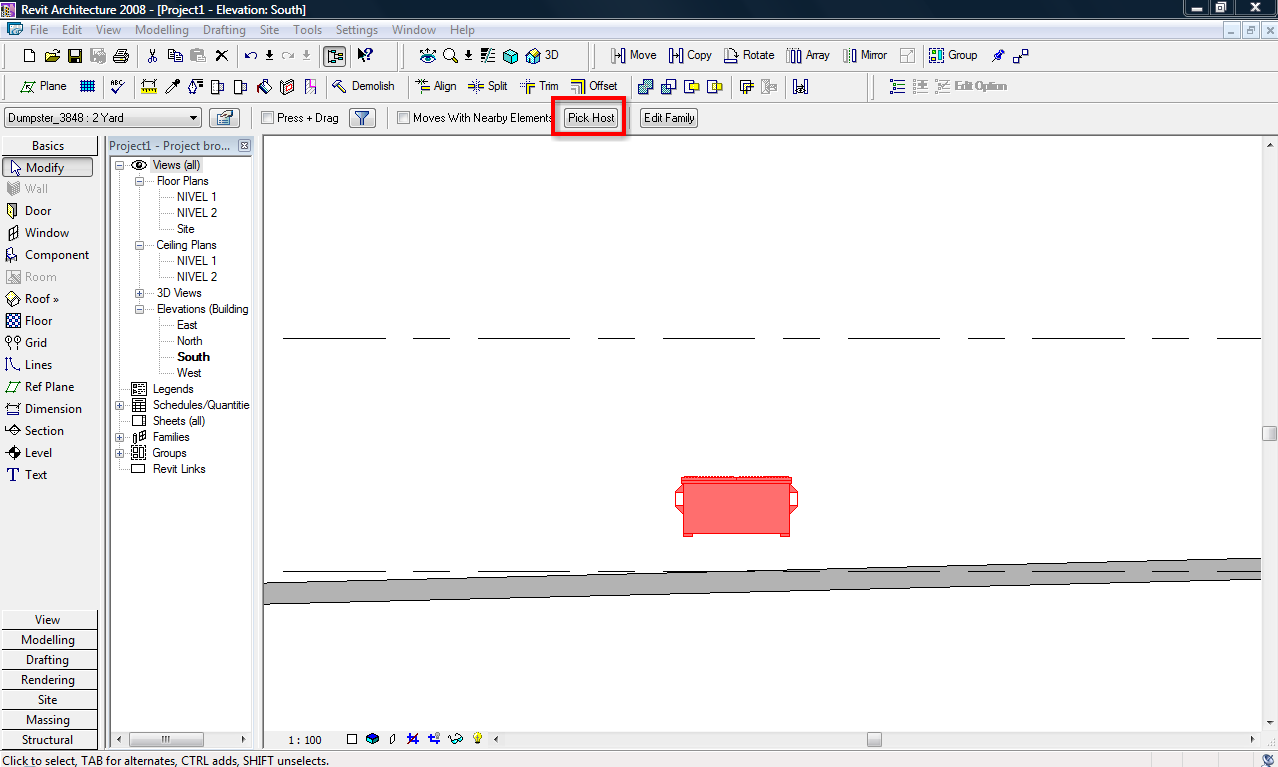

Edit your dumpster, and in Settings--> Category and Parameters, uncheck Always Vertical, load into project and then in your project pick your dumpster and Pick Host buttom and pick your slope......
