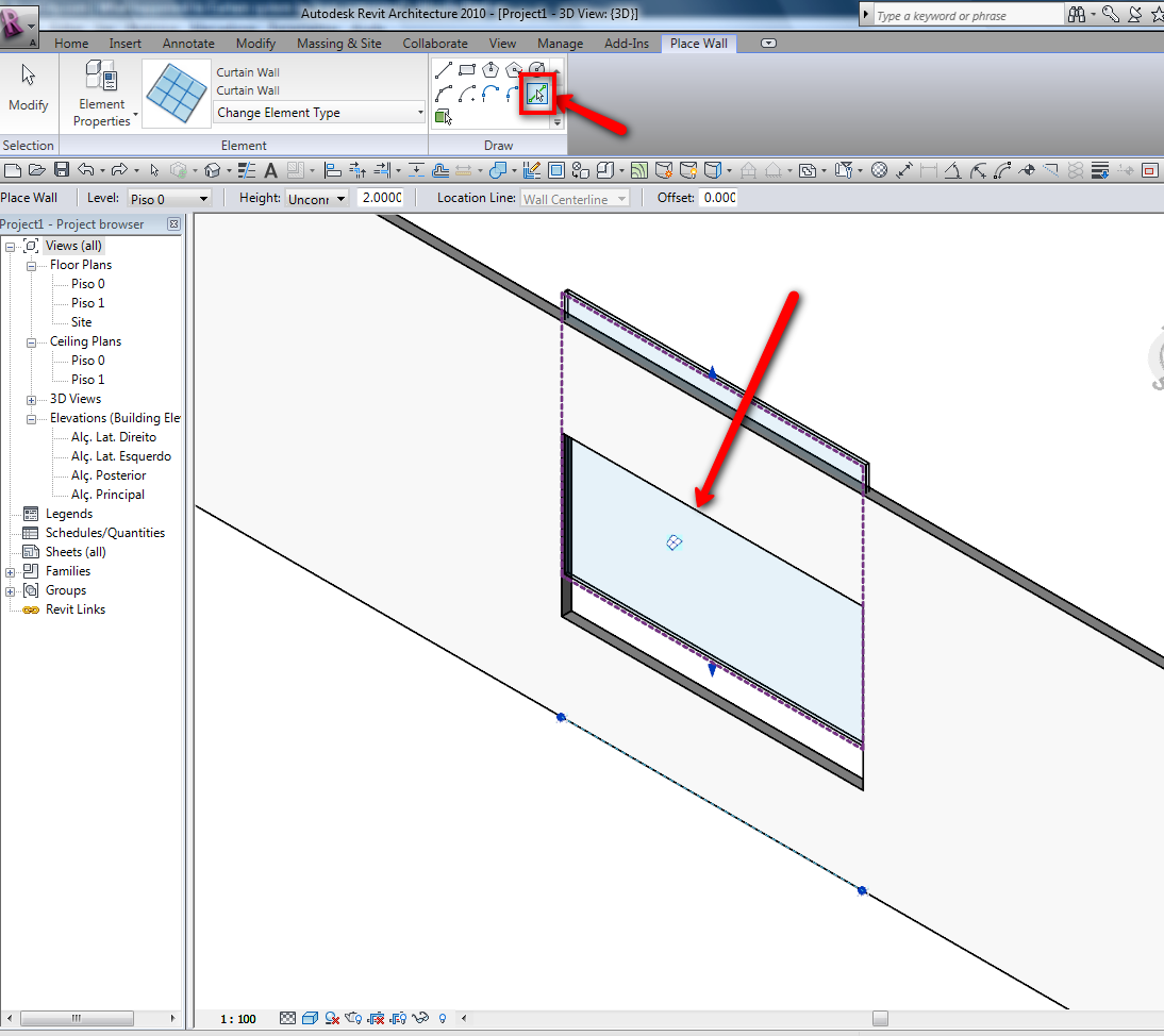

i see it in Revit 2009...did they get rid of it in 2010?

The traditional curtain system by lines command disapear but you have always the possibilitie of create a curtain wall by pick in line then adjust the height...

ya i wanted to use it to make a wall system on a canted wall so the curtain wall wouldnt have worked. its ok tho. figured somethin outSmile
the wall was based on a mass and the grid lines followed that mass, which i didnt want, same thing prolly would have happened with the  curtain system by line

Create a roof by extrution. And make the roof sloped glazing.
