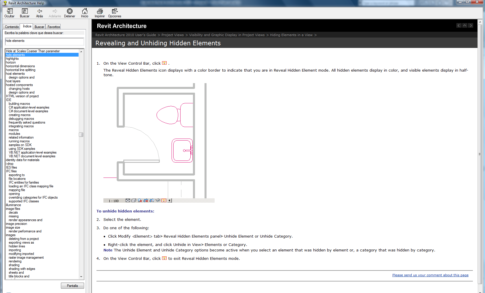

WYS1WYG, did you read your HELP menu, "Unhiding Hidden Elements"?

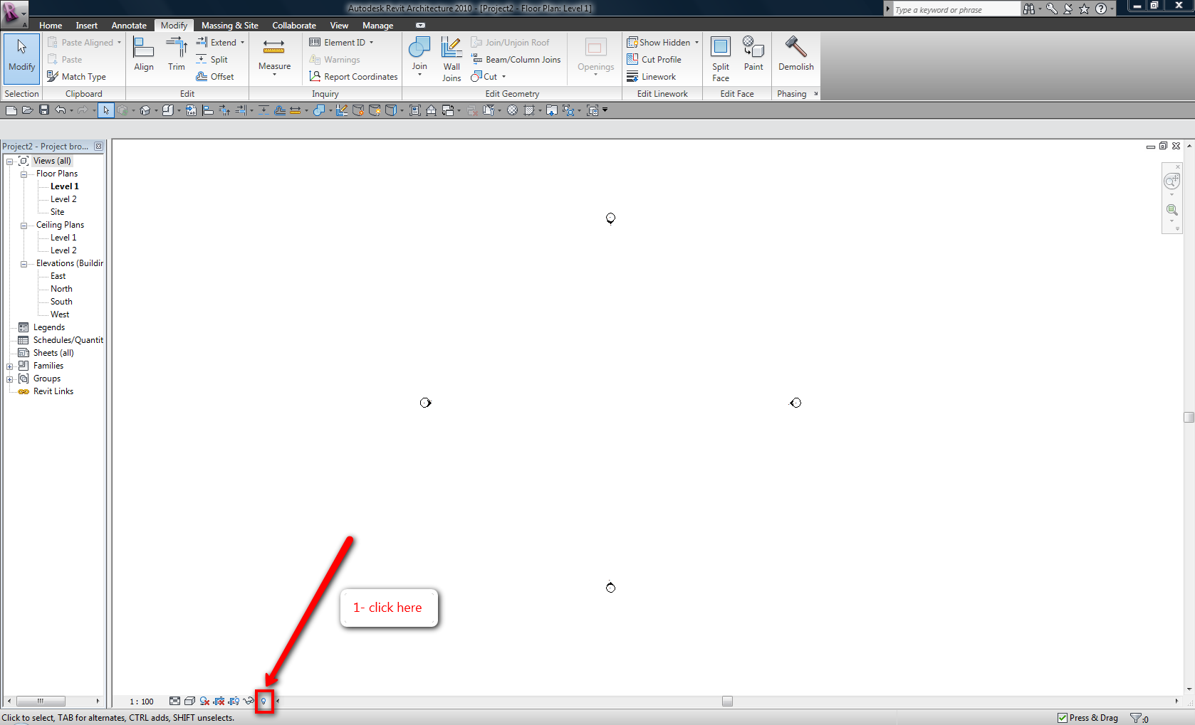

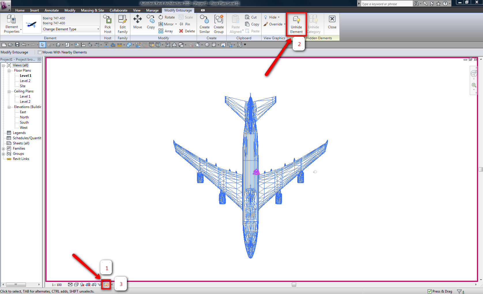

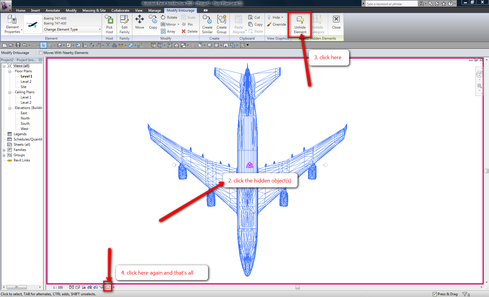

WYS1WYG, see the attached images....

got it- thank you..
