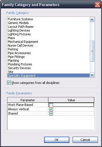

First of all, whatever the components you're using to create the curtain panel, you have to put them into some other category, not in 'Generic Model'. You can do this by going into Settings --> Family Category and Parameters. For example, you can put them into Speciality Equipments.
 Then you have to make them shared. This can also be done from the same menu,  Settings --> Family Category and Parameters (see attachment). There is a chec-mark for it on the bottom to make the family shared.
 Now after loading them into curtain panel family and load the panel into Revit project.
Now when you create a schedule for 'Speciality Equipments', you'll see all your components you used to create the panel family.

Thanks for the insight. By changing the Category to Specialty Equipment all sub-components did appeared in the Schedule.
