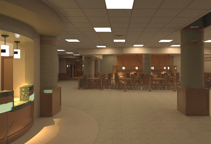

Has anyone used the artlantis 2.1 plug-in / renderer with Revit 2010?  I have a complex interior scene with lots of lights, objects, and curved surfaces.  Revit spent 5 days and 22 hours on it and crashed and 98%.  Is artlantis a good option, or should I just do what autodesk wants me to and use 3DS to do the scene?

I did use Mental Ray - on Best - 300, and at the time didn't know how to shrink the image size (scale) so it cranked away for days and days, then crashed.  Just looking for a faster option for interior renders.

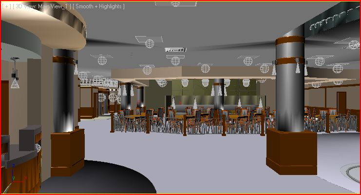

In your Revit model if you are using IES files for your lighting when you export to FBX and import to Max it will retain the light properties as well as your sun and location settings. There are many tutorials on Revit to Max online. here is a good resource

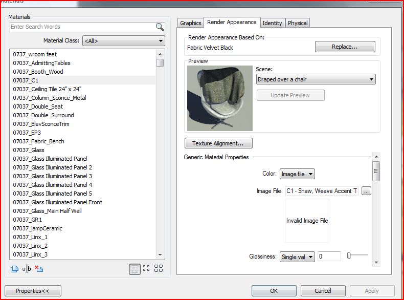

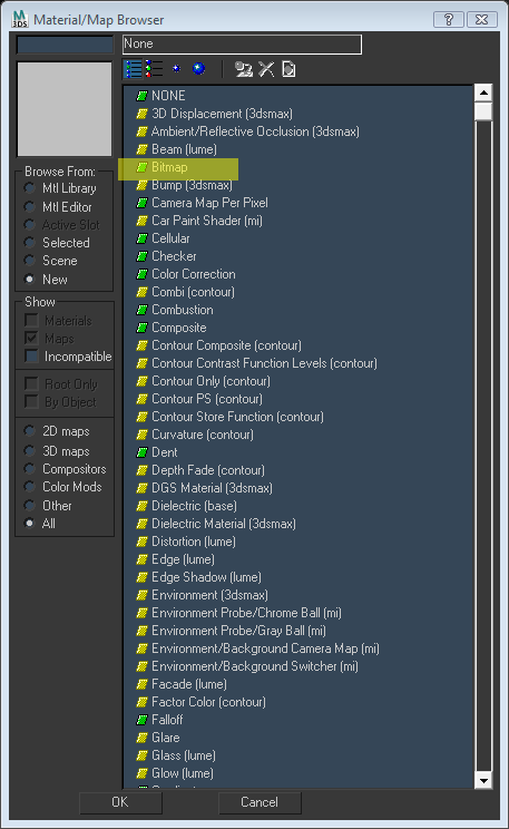

alabaster....I exported an FBX and it picked up the scene / lights nicely, but my custom materials didn't transfer.  I know it has been posted elsewhere, but now I am having trouble locating the info when I need it.

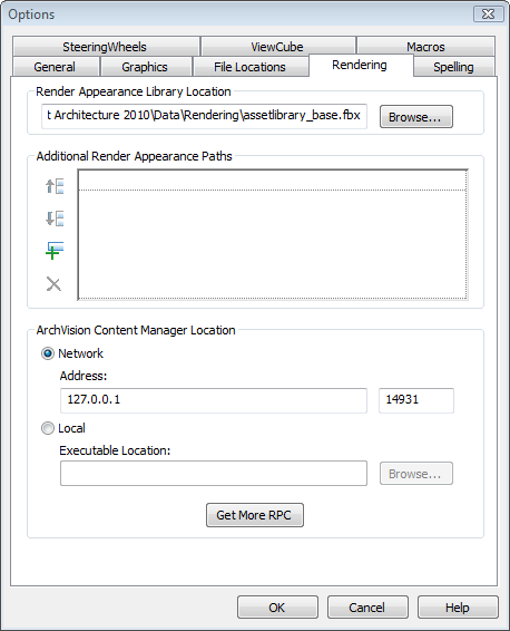

How do I add another folder (location of my custom materials) to the library.  When rendering in Revit, I have to re-link constantly.  Isn't there a way to permanently link it, so I don't have to constantly tell Revit where the material is?
 I think that is the reason my materials did not transfer to 3ds.  No?

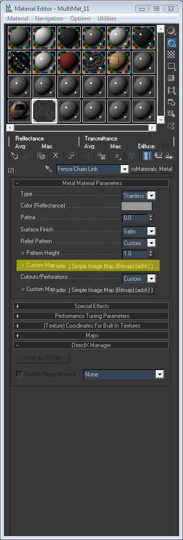

Possibly you need to add the path to your custom materials to your render path? The ProMaterials in 3ds Max do not always show through, you may be looking at something gray in screen that actually renders a material. What I do once the FBX is imported is run through my materials and replace the (bitmap) (adsk) with a (bitmap) image. I only have to do this to the materials that do not show in my scene. When you import the FBX it create a folder of present materials wherever your FBX is located. This will have all the materials definitions from your Revit scene.

yeah I see the folder you are talking about, but it has some random materials that are not used, instead of the images I want to use.
How do I add the path to my custom materials in Revit?

Alt+F, I
that keystroke will take you into the options dialogue, then just click the rendering tab

awesome!  alabaster...you are the man!  I knew that option was in there somewhere.  It is nice to not have to continuosly reload my content anymore.  Unfortunately, I re-exported the fbx and it looks about the same materials wise.

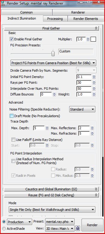

What presets do you normally use as a starting point?

yeah your scene appears that way becuase the bitmap (adsk) shader does not display the material map. Like I said before I usually replace the bitmap (adsk) with a normal bitmap and use the same texture map. That way I can see the scale.
Your FG settings are fine for draft renders, for that interior I would also set up a global illumination without FG. Once you have a good lighting solution you can burn both FG and GI to file and save a ton of time.
Also try messing with hardware acelleration so you can use the directX for your graphics card to get a more defined look to your viewport. it will display all your lighting and shadows in realtime
