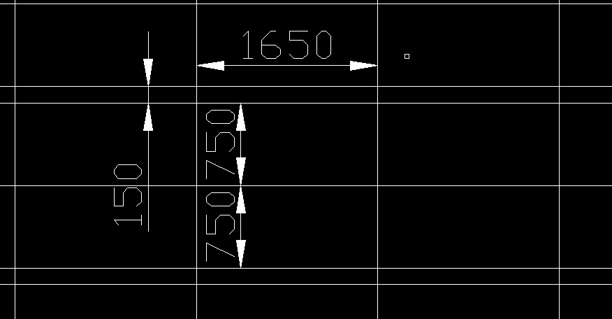

Dear All,
I am hoping some kind soul out there will be able to help me out with this. I desperatly need a hatch patten generating for a live project. I have tried all the free hatch generators i can find but with no luck. Im looking for the pattern to complete,,(or at least start) on some ceiling layouts. Ideally im looking for a metric scaled pattern as per my image attachment.
Any help or advice would be greatly welcomed.
Thank you.
J.

Thanks Tim, your explination sheet is great. I have had a go at it but im still struggling with the horizontal spacings. It appears that method of inputting into the Pat file only works on regually repeating offsets though.
Im needing the horizontals to be spaced at 750, 750, 150. Is this possible?
So far all i have is :
 90,825,0,0,1650 for the verical lines.
Thank you

Sorry Tim,
I think i just needed to think about this a little further, i realised that the answer was.
90,825,0,0,1650
0,0,375,0,1650
0,0,525,0,1650
0,0,1275,0,1650
Thank you for your help.
