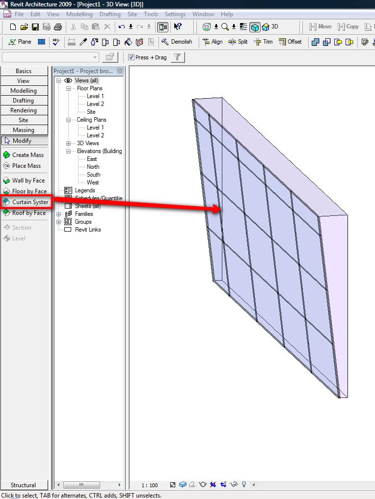

My issue is sort of related to this post:  I have walls sloping in elevation that i need to make a curtain walls so that i can model standing seam aluminum siding on them.  I've massed the walls and planned to apply walls by face, but only basic wall types are allowed.  no curtain walls.  does anyone know how i can model the siding on these sloped walls?  I've also tried wall sweeps but the sweeps won't host to those walls.  Thanks.  revit architecture 09.

Hi alibi0614, have you tried with "Curtain System" instead of "Wall by Face"??....

of course!  why didn't i figure that out on my own?!  thanks erland73!
