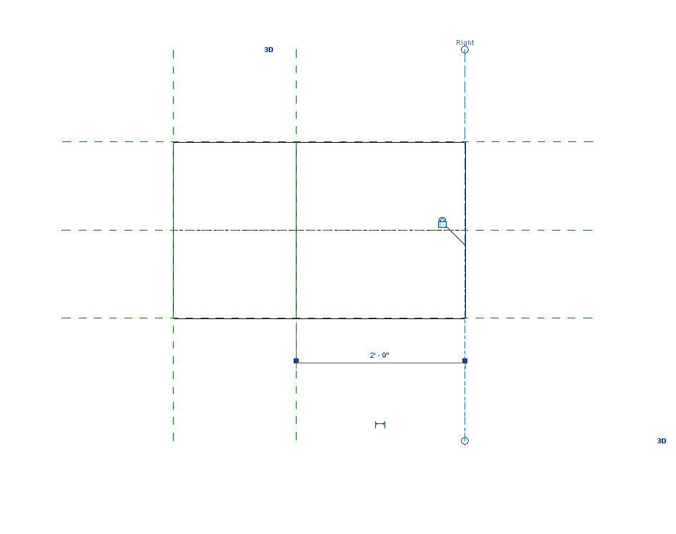

OK, Check this scenario out that has been driving me crazy...
Here is a basic bunch of 2D lines locked to some reference planes:
See how everything flexes nicely when I drag the Right reference plane:

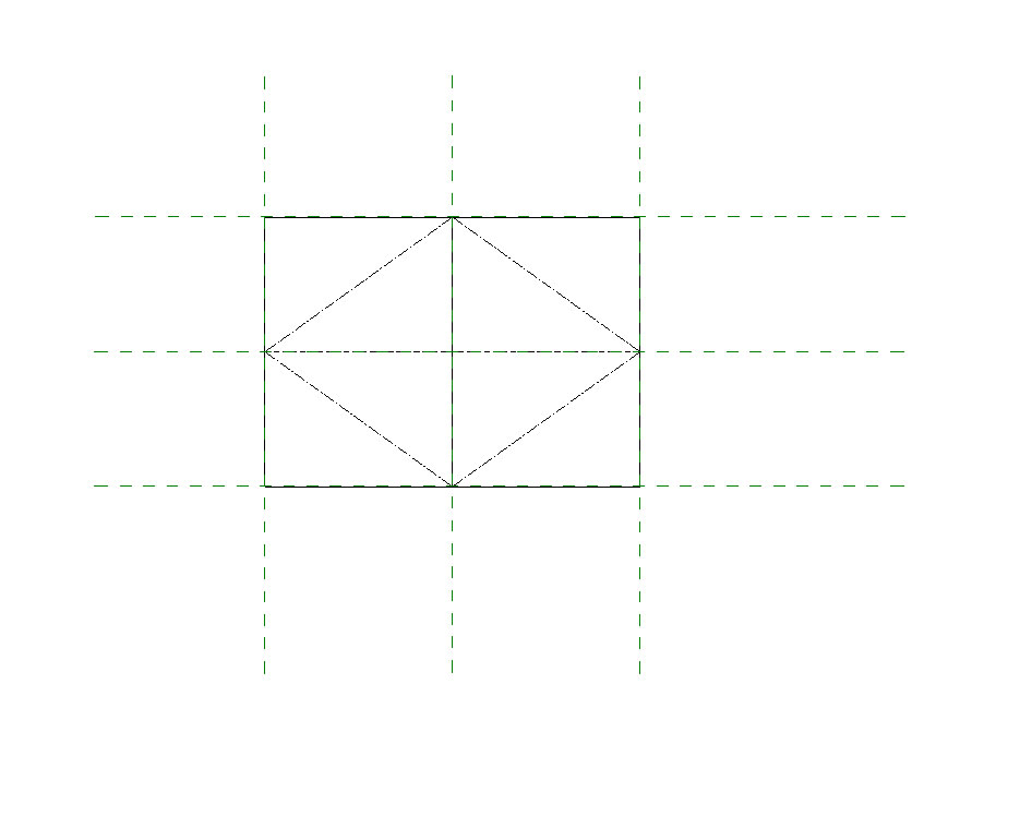

Now I'll add some diagonal lines and lock them to the outer reference planes as well:

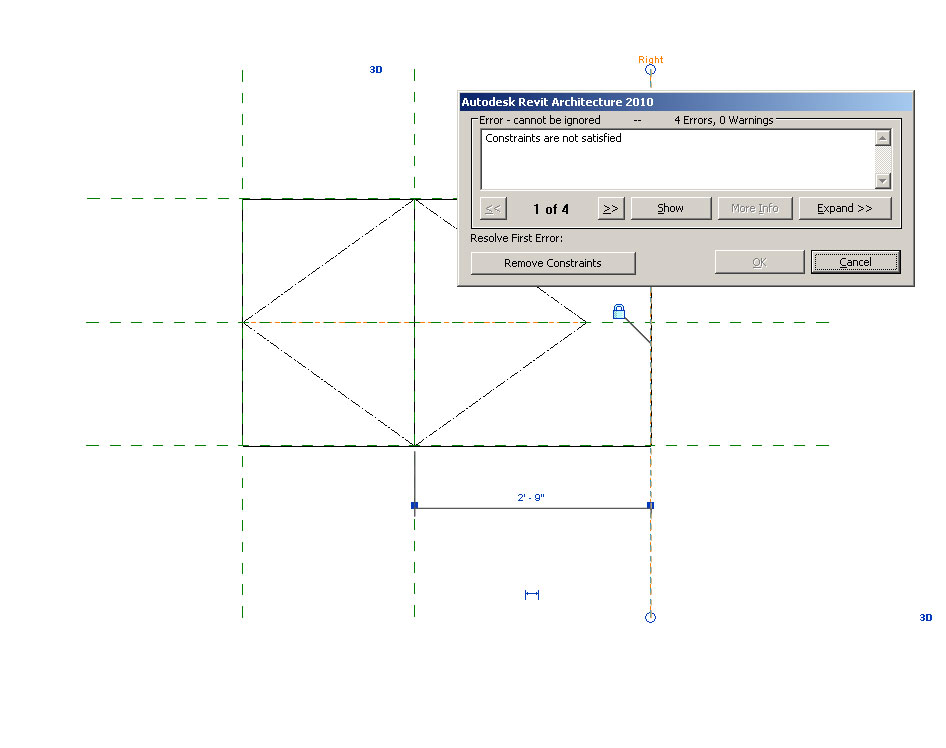

See how I the constraints cannot be maintained for the diagonal lines:
My question is... WHY!!!?

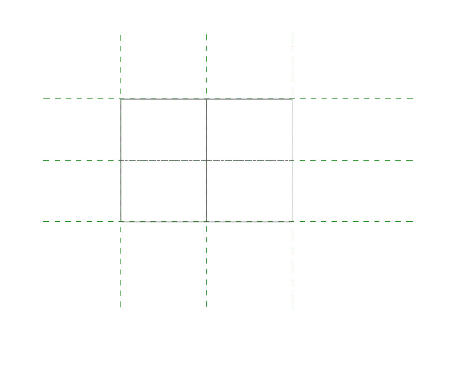

I have done this before, I drew 1 single diagnol line to the intersection and constrained it. once I verify that single line would flex i then mirror it around and voila, it worked.

if you add the diagonal lines and lock them, then you are telling Revit to keep them at that angle. So Revit is correct in telling you that "constrains are not satisfied". because it would be impossible to keep the lines at that angle without changing the witdth and height as you flex the the shape.

Here you do not want to lock to the plane of the line. In this instance you want to lock to the end point of the line. When ready to lock the diagonal line to the plane (at a mid point plane also) click on the plane and then tab over the model line and find the point, when you have that point highlighted click on it.

My first suggestion would be to look at the out of the box door families.  In elevation, many of them have swing lines that are diagonal lines that flex with the door width/height.  Take a look at those and see if you can decipher them.  I think you'll find the key is not constraining (actually locking the lines) but letting Revit use it's "smart" constraints for the diagonal lines.

thanks rkitect ... I was being stupid and trying to lock ... This is proof that locks can get you into trouble.  REVIT assumes some associations on its own and you don't have to lock everything ... and in this case, if you notice, Carl doesn't use any locks at all.

I think your main problem is your associating the four lines of your diamond to each other and this is preventing the flexability your are trying to achieve. By first creating a single diagonal line that flexes both vertically and horizontally then mirroring this element you are creating 4 completely independant lines that are able to flex vertically and horizontally. That is how you are able to prevent all four lines from maintaining their original shape.
