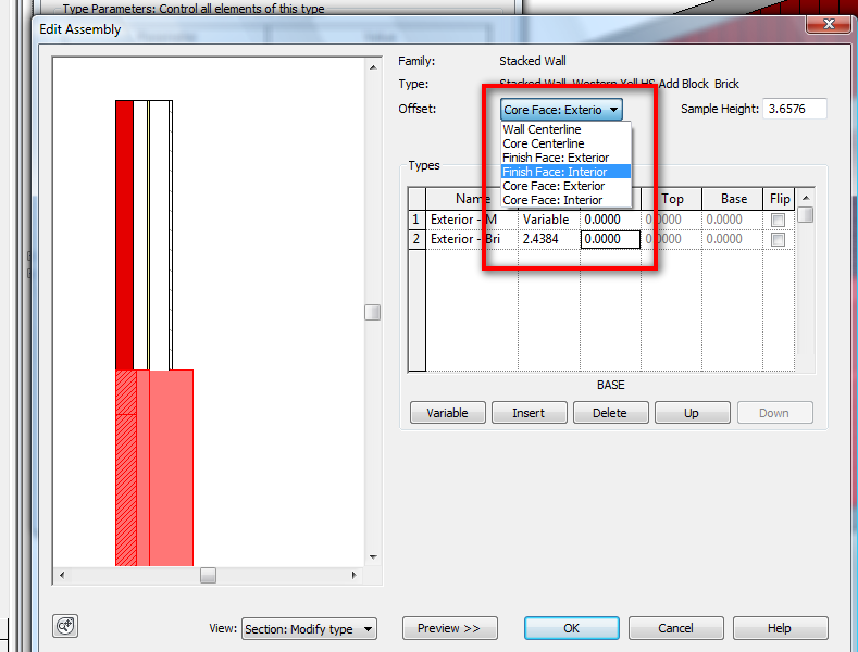

I have a stack wall with both walls and the stack wall alignment set at finished face exterior.  I am sure that I am doing something stupid, but I am unable to get them to line up on the exterior face.  See attached.  Any suggestions?

Did you try the "Offset"?

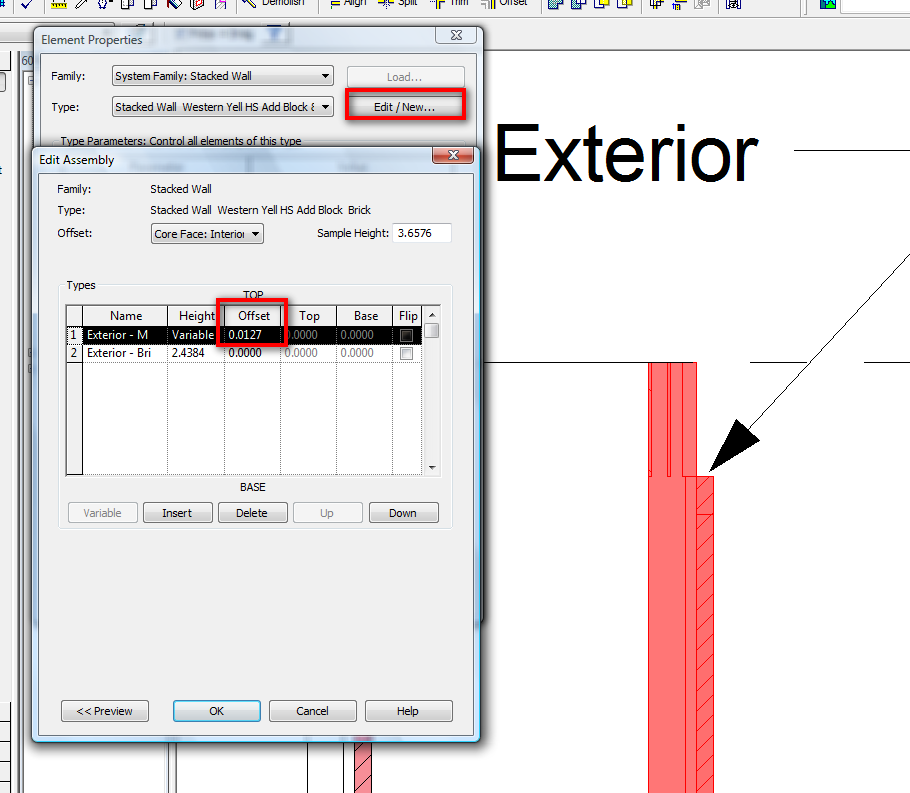

Also:

...............assuming that the alignment line had anything to do with how the different walls fit together in a stack wall.  It appears that the default alignment is the inside finished face since that is how these two different width walls fit together.  Is that the default?
Thanks for the help.  The offset tool applied to the stack worked perfectly.  I have used this for sweeps in the past but the fact you could use it for stacked walls flew right over my head.
