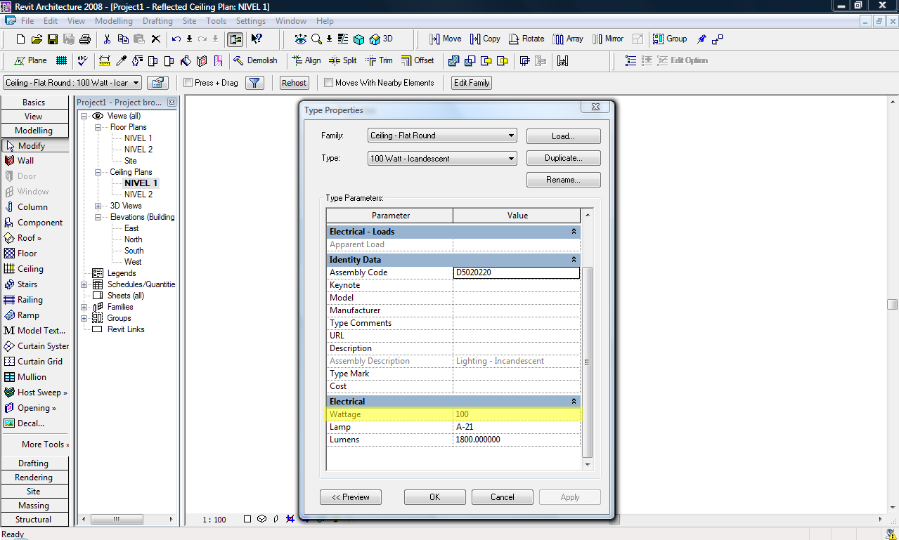

1. My render time is always set to 7:30 pm 5/10 boston time.  This is the only way to get the interior and exterior lights to show up.  Whats the secret to get the lights on in the day time?

1- Try to increase the value of your (watts/Lumens) interior lights, if you search in the forum you gonna see several threads about this.

1. See attached....

In retrospect, the answer was the 'adjust exposure' button in the Render Tab.
