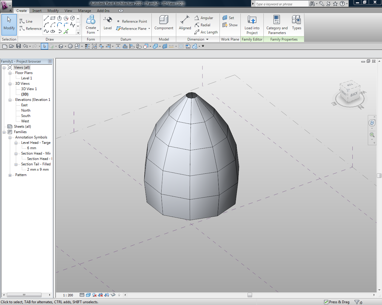

Anyone know how I am able to get a revolved object to actually have faceted surfaces instead of a perfect circular revolve?  I want it to go all 360 degrees around but want some facets to the object.
Tue, Jun 2, 2009 at 12:59:27 PM | Faceting a Revolve instead of Smooth Result
Do it in Cad revsurf and set your surftabs then import.

OR you can create that in the new conceptual mass if you are working in 2010, of course...

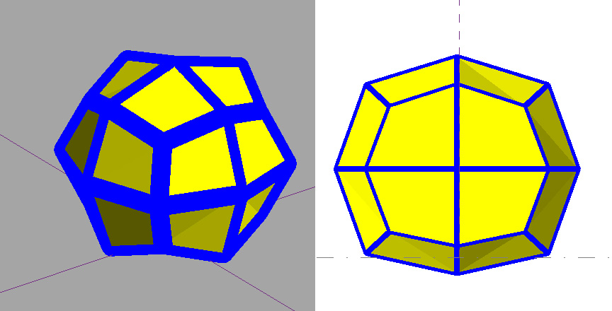

an image of the object i'm trying to create to bring material to it.  I brought it in from 3ds, exporting it as a dwg file.  The object doesn't accept the paint tool and is not considered a solid object since 3ds doesn't make objects like revit does.  What is the best way for me to either recreate this object in revit, or add a material to a dwg file that was inserted?  Thank you in advance to anyone willing to provide the answer.
Wed, Jun 3, 2009 at 6:41:52 AM | Faceting a Revolve instead of Smooth Result
#11
If this object is now 3D dwg, you can assign materials to it by layer. In the project - settings/object styles - imported objects tab.  Fid the dwg - expand it so that you can see the layers - now assign your materials.

i assume there is a way to build it in revit, but I'm not sure how to go about it.  I tried the settings, layer material option and that had no effect.  I was thinking the easiest way to build it would be to just revolve the faceted profile 360 degrees and changing it to be more like an 8 on the revsurf in cad, but I don't know how to access an option similar to that in revit.  If you have another way to build it, I'd love to have it explained.
Fri, Jun 5, 2009 at 11:25:07 AM | Faceting a Revolve instead of Smooth Result
#15
tim123
Joined: Tue, Apr 12, 2005
1310 Posts
4 Stars: 19 Votes
I can't quite make out the shape, but it would appear that you could create that from two blends.
