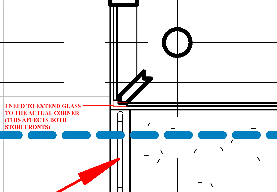

I have a situation with an exterior curtain wall.  The mullion is a 45 deg. mullion which is pulled behind the glass to create a corner but joint.  However, I cannot get the glass extend beyond the mullion.  This creates a gap.  I would just draw over with details lines, but this effects all of my exterior elevations as well.  An image is attached, so any help would be appreciated.

Not sure how the mullion was created. But with mullions, if they interesect the plane of the panel , they will break the panel. try offseting that mullion a little more and see if that will get the glass to butt up against each other.

I have spent many hours trying to get what you are trying to accomplish... It wont work. I just created a family that I place in the corner of the curtainwall

Well, the gap exist even if you "move" your profile in the family, the glass cross...

Typhoon - this only works if the glass is the Center of the CW.  We have the Center of the Mullion as the center of CW.  But your solution could work in another situation.

Correct, they will not meet, nor 'miter', an in all actuality does not do so in 'real life'. If you want to go to the trouble of creating a new panel style that stops short of filling in by 1/4" and when placed in curtain wall there will be a more accurate depiction of real life, where the glazing stops and a sealant joint is created. but this is a lot of work for minimal gain. what you have now will render fairly accurate, and if you dont like the overlap in plan, depending upon the scale, you might try joining the geometry.

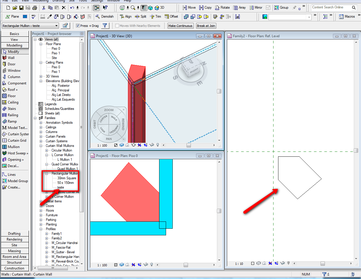

Wed, Aug 2, 2017 at 1:57:54 PM | Corner Mullions not extending glass to meet
You can vary the shape of mullions by loading new mullion profiles into a project. Also, you can create a custom profile.
Read ThisAnd This
You will need a left and right.
I believe you may also find some already made in some of the CW's available on Autodesk SEEK.
