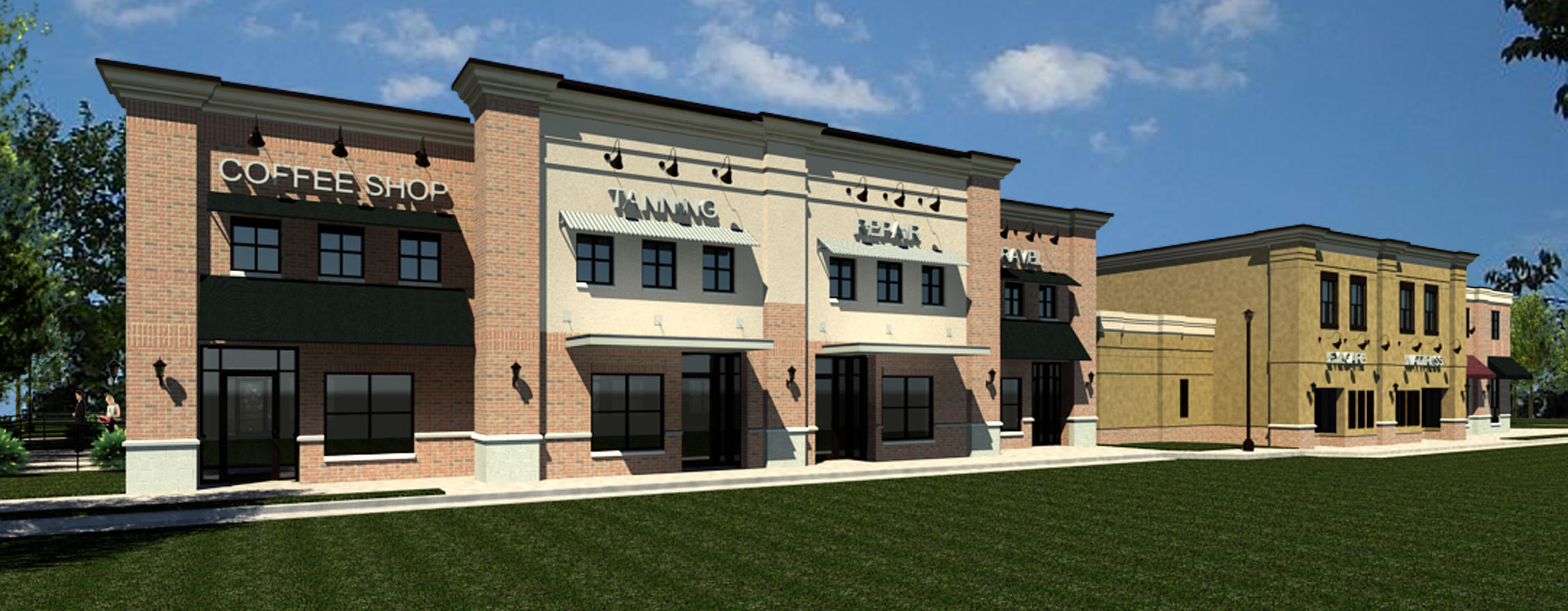

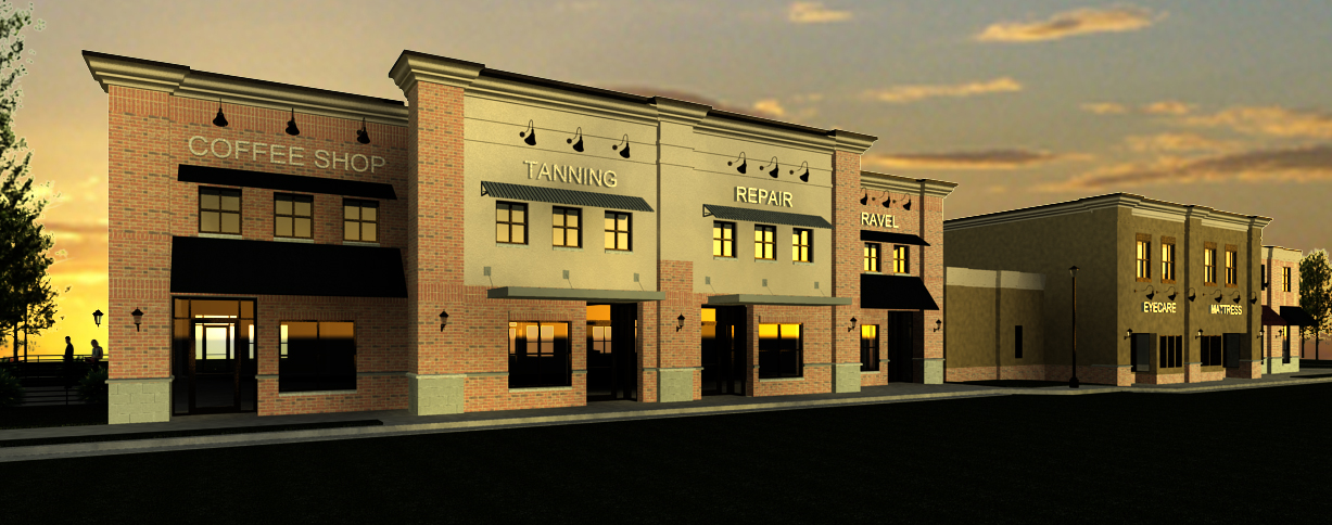

O.K. I've been using Revit 2009 for a month or so and have tried everything to get this gray line out of my renderings. I have searched for days through posts and threads on how to get rid of this. I've tried turning off ground plane in advanced model graphics, tried it agin checked on and set the ground plane at a level 200' below my building, tried adding a toposurface lower than my ground floor, and numerous other variations of the sorts. All the posts I see refer me to the older versions where there were 2 places you had to turn off the ground plane. I've only came across one in 2009. Is there another one that I am missing? My image is attached so that you can see what I am talking about. Thanks for any help.

I dont render much in revit but when I have had this problem I have done two things. 1. created a large decal image parallel to the project that will render as a reflection, I did this a long time ago and had some issues with scaling but eventually it worked. 2. I add in some basic modeling and entourage that will show in the reflections.
Or i guess you could turn the reflectivety down on your glass maybe?
