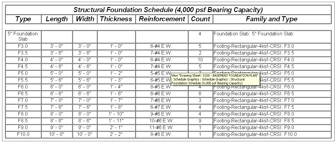

Fri, Dec 2, 2011 at 9:10:40 AM | Foundation Schedule - no footing thickness field - help!
#9
seniorcad143
Joined: Fri, Oct 2, 2009
140 Posts
1 Stars: 1 Votes
This is what I get with the OTB schedule with a few added parameters.  I just typed in the reinforcing, but I would like it to model it in (unless this is not practical for size of file problems).  Also it is not showing the footing thickness - I included both the "thickness" and "foundation thickness" to see if one of them would show the isolated footing thickness but neither of them works.

Fri, Dec 2, 2011 at 9:44:54 AM | Foundation Schedule - no footing thickness field - help!
#10
seniorcad143
140 Posts
1 Stars: 1 Votes
OK - i got the thickness to show - doing what eyanovich said to do.  Don't ask me to do it again, because I was just clicking and typing and changing, loading into project and reloading, and.....
Happy that I got that part but sad at the same time!  (Pretty sad isn't it, when you have done something and you don't know how or why you was changing and adding what you were changing and adding.)
Anyway - I still need to figure out how to get rid of unwanted foundation call outs in my schedule, also it list the same type multiple times - how do I get it to list each type just once?

Fri, Dec 2, 2011 at 9:51:10 AM | Foundation Schedule - no footing thickness field - help!
#11
seniorcad143
140 Posts
1 Stars: 1 Votes
ok figured out how to get it to least each type once.
Now how to get rid of everything but the isloated footings... hhhmmmm.....

Fri, Dec 2, 2011 at 9:58:00 AM | Foundation Schedule - no footing thickness field - help!
#12
seniorcad143
140 Posts
1 Stars: 1 Votes
ok - i don't knwo if this is right but I told it to filter it by the new "Thickness" parameter I added, and it worked.
again - I don't know if this is right or how I did all of this but...
Still need to know about modeling in th reinforcing
  Should I or shouldn't I?
  and how do I do that - right now I just have it as text?
