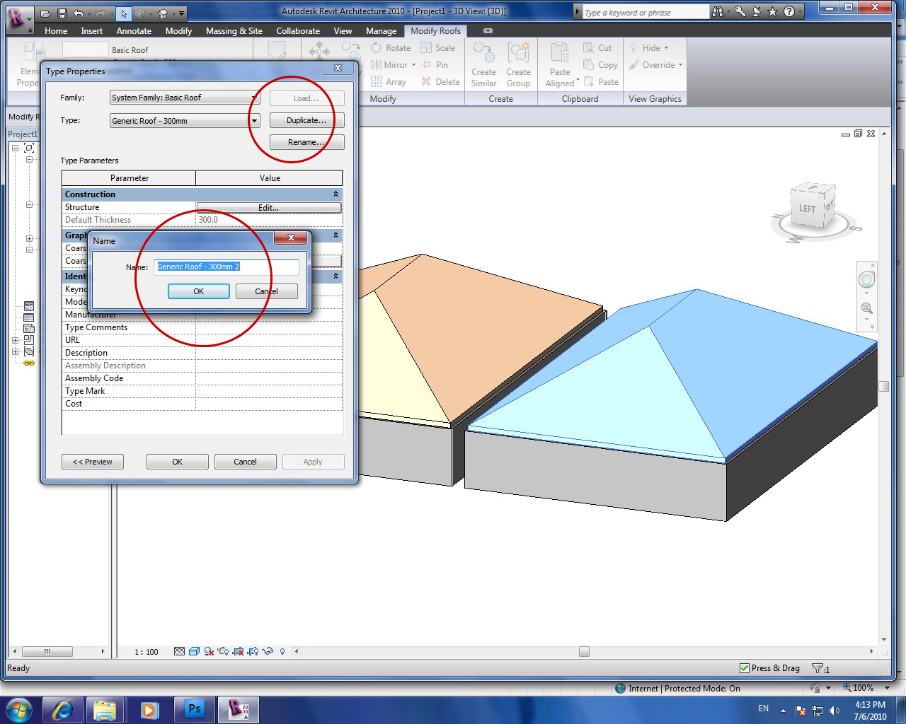

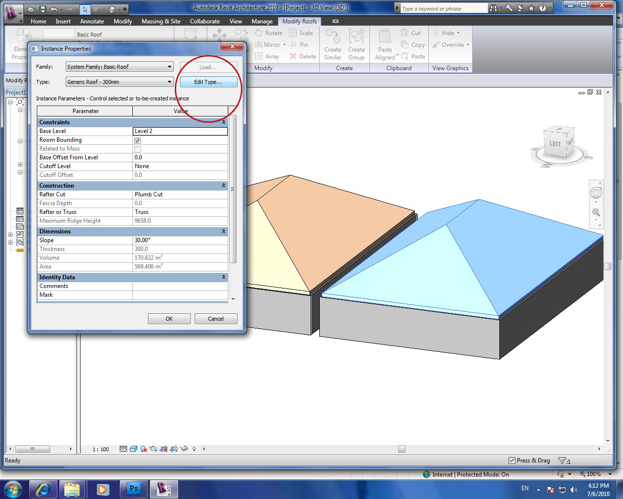

Tue, Jul 6, 2010 at 8:17:52 AM | New Render Appearance
adiga
Joined: Sat, Dec 27, 2008
13 Posts
5 Stars: 1 Votes
you need to dublicate the roof itself and then rename the duplicated one wiyh
another name.
and then you can assign each of the roofs one of the materils that you created.
Tue, Jul 6, 2010 at 9:45:22 AM | New Render Appearance
adiga,  I think you should re-read the original question because it was about two different materials in the same roof, not two roofs.
