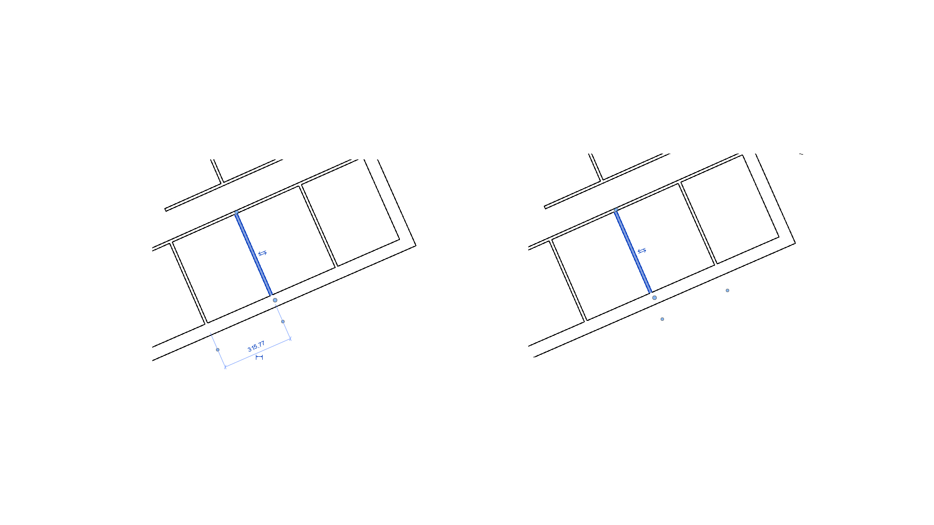

I have the same kind of problem.
I am using revit 2015 and while drawing walls or annotating them, the annotation just disappears when I switch it to another object (a different one than initially shown by revit).
When I try to use the aligned annotation tool, same thing. it snaps to the wall but the annotation just does not show. I have no idea what to do to resolve that problem.
I've uploaded an image of the issue.
Tue, Nov 25, 2014 at 12:54:35 PM | Dimension won't Snap
Have you got an annotation crop window on?
Also note that the walls will have to truely be parallel if you want a dimension between them.
Tue, Nov 25, 2014 at 2:08:13 PM | Dimension won't Snap
Phoenix882
Joined: Tue, May 7, 2013
0 Posts
Thanks for the quick reply, it seems my walls are not really parallel for whatever reason.
