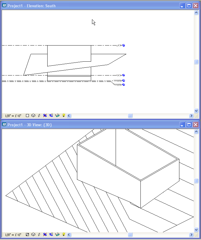

Hi everyone, I'm new here (shy smile).  I've learned a lot from all you boffins out there but I have yet to learn this one thing (and then many more I'm sure):  Can revit (either 9 or 2010) cut the geometry of a site to display base line?  The attached image shows where the stone wall.
Thanks!
Seeker

Ok, perhaps it would help if I complete my sentences...
The attached image shows where the stone wall... meets the topography.  But there is no line there!
Can Revit handle this??

If you turn on shading with edges you will see where the topography meets the wall, but it won't show with hidden line.  If you need the line, trace over it with Shading turned on and then switch back to hidden line mode.

Yeah, you can't use the "join Geometry" (even in 2010) to join walls with topo site, i think WWhub was thinking in another issue when he reply your tread, but do like Tim said, in the elevation view where you need that line, create one....

I'm not sure if this is the answer or not, but what if he used a building pad for his footprint and try joining his walls to THAT and then show his building pad to be above the grade line?  For the projet I'm working on it seems to work.  For that matter, I have used my building pad as my initial floor because I was able to create an 8" pad that also showed the 8" stone underlayment as well.  Works nice for my wall sections.

Mars said to use a pad and to join geometry of the walls.  The pad is the answer - the join geometry of the walls does nothing for you.  Typhhon too told you to sketch along the outside of the walls for your pad.  If you create the pad to the outside of the wall - that is what cuts the site and what you see in the images I included.... THE SITE EDGE where the pad has cut it.

Seeker, don't argue with WWhub, he can be your best friend here, also you said and i quote: "Pads are not joinable geometry either so I'm wondering how this works for you guys?" - yeah BUT if you create a section view cutting that wall and the pad, and if you pick in that wall you gonna see in top and bottom the "Blue Arrows" of the wall, so if you pick in the blue arrow in bottom and drag to touch in the top of the pad you gonna see a "open blue pad lock" click on that and the pad lock is now closed, in this way you "Attach" the wall to the pad, you move or drag the pad to up or down and you gonna see the wall attached to pad....
