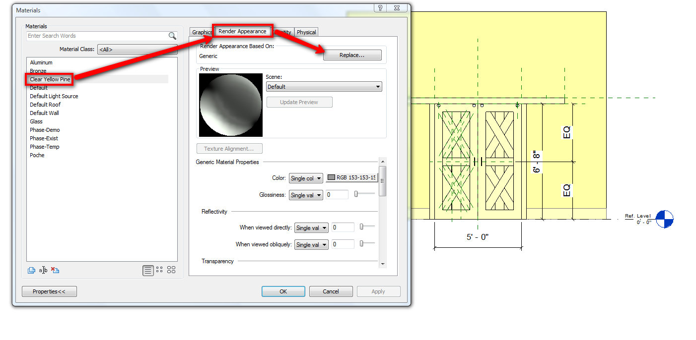

Hello,
I downloaded some families at RevitCity but when I wanted rendering my project these families are just white.
I tried to edit these families and changed the elements properties but when I downloaded the edited families in my project , they are white.
How can I modified the elements properties of these families?
Family example: Double_Barn_ Door_2211

Comment allez-vouz mon ami?...look, open your family file and go to Settings-->Materials... and there just pick "Replace" button and change its materials i.e. "Clear Yellow Pine" for one of the Render Appearance Library materials (See attached). This happens because your door was made in an earlier version of Revit. J'espère que cela vous aide....au revoir!!!!...

Well, if you have already loaded this door into your project, change the material there (I mean in your project file not in the family file, this because you have it already loaded). "You told me that happens because this family  was made in the earler version of Revit, does that mean I can never change the materials for the rendering?", of course you can, just open your family files and assign the new materials in the Materials Dialogue box and save before you load them into a project. Do it even with the rock_15 you are talking about. Merci mon ami, Je veux practiquer mon français un peu...

1/ I clic on  my Double_Barn_ Door_2211 in my  first plan view or 3d view
2/ I clic on "edit Family"
3/I am in family file. I click on a element of my family
4/I clic on "Instance properties" and clic on the row "clear yellow pine ... "
5/ materials box  appears. I clic "apparence" and "replace" by "Wood Elm Burl Stained Light No Gloss" for example.
6/ I apply and say OK
7/ I load this family in my project
8/ I chose " overwrite the existing version and its parameter values"
9/I "rendering", and it is still write.
 Did I do something wrong?

In your Project go to Materials and find that material "clear yellow pine", check if it have the right material you want....

Thank you very much Erland73 and Typhoon. It works now because I founnd "Manage" and "materials" in My project
My door is finally not white in my rendering.
