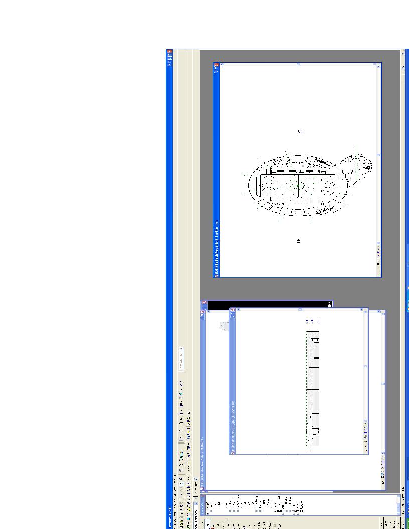

HI,
So i was wondering if anyone knew the answer to my problem here.
 im trying to show the roof in this east elevation but it doesn't show.
the floor plan shows where the elevation is being seen at and its at the same spots for the south and north elevation and you can see it in there.  but for the west and east elevations it doesn't show at all.
the visual setting is on and everything that supposed to be on is on.
Does anyone have any info on how i can fix this.
Thanks

Mon, May 25, 2009 at 9:55:57 AM | Domed Roof not showing
jdivina
Joined: Fri, Sep 12, 2008
59 Posts
Sorrry that didn't work here is a jpg of the problem
JD

Mon, May 25, 2009 at 10:10:01 AM | Domed Roof not showing

Mon, May 25, 2009 at 10:13:31 AM | Domed Roof not showing
jdivina
59 Posts
ohh
where can i find or view the dotted line with the arrow.
i only have the blue line when i click on the arrow from the elevation marker.
and i can move that but if its the blue line its right in front of the building.
like if i put the blue line in the middle of the building it shows a section instead
but the blue line is right in front of the building
JD
Mon, May 25, 2009 at 10:17:12 AM | Domed Roof not showing
jdivina
59 Posts
so when i was reading your idea
i checked my view depth on my view properties.
it seemed to show the roof now
when i changed the view depth to clip with line and changed the value to  a certain n umber.
thanks for the help
it took me awhile just to get to that point.
JD

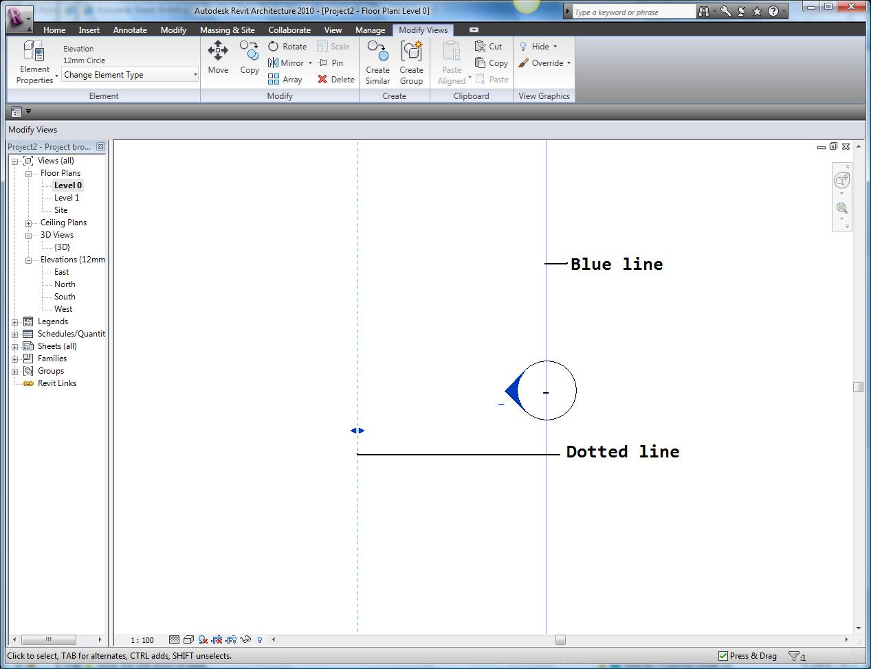

Mon, May 25, 2009 at 10:23:39 AM | Domed Roof not showing
tim123
Joined: Tue, Apr 12, 2005
1310 Posts
4 Stars: 19 Votes
You can adjust that in the view properties or in a plan view - see image (I can't see which version of Revit you're using though).
Mon, May 25, 2009 at 10:29:34 AM | Domed Roof not showing
jdivina
59 Posts
i am using the 2009 version.
it doesn't seem like we have that dotted line
or i just don't know how to get it
JD
Mon, May 25, 2009 at 10:38:48 AM | Domed Roof not showing
#9
jdivina
59 Posts
nevermind i found the dotted line
thanks for the help
JD
Mon, May 25, 2009 at 10:50:38 AM | Domed Roof not showing
#10
tim123
1310 Posts
4 Stars: 19 Votes
There's no dotted line if the Far clipping is set to 'No clip', but then you should see everything in the elevation.
