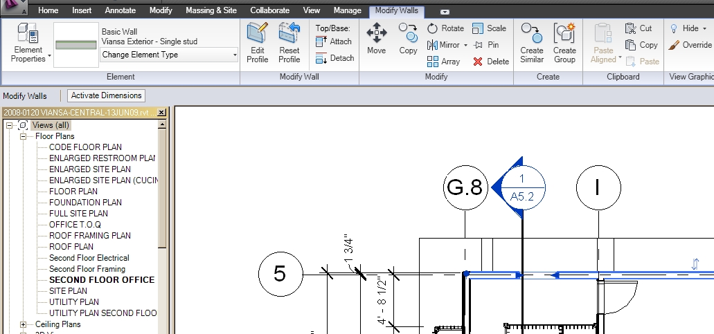

I am a new user switching from RAC 2009 to RAC 2010. Searching both versions' help menu for "activate dimensions" yields no results. Am I looking for something removed from the 2010 version of the program, and if so, what replaced it?

It's on the options bar when you select some items.

yeah its very small on the options bar in black and white after you select something. It works the same as before just harder to see like everything else.

I am confused I can find activate diminsions when in the family editior, but when I select a wall in 2010 I can not find the option.  Could someone please shed some lite on this issue, it driving me bonkers. I keep feeling like downgrading to 2009, but I know from exprience with A-desk they are not going back.

I just selected a single wall, and it pops up in the top left corner under Element Properties, see attached screenshot.
(I think I just sorta answered my first question at RevitCity!)
