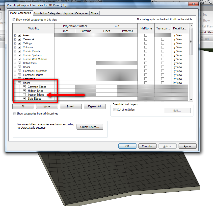

I've "searched" this topic but it seems most answers are that it's not worth it to model compound slab/roof slopes (sloping more than one direction).  That may be fine for construction documents, but I'm modeling a structure to a high level of detail for use in clash detection in Navisworks, so I need to know exactly where my slabs are.
 Is there a way to model a "flat" roof of multiple ridges and valleys and varying spot elevations?  I've run into the same problems others have with slope arrows in that I can only slope in one direction.  I would even create separate triangular planes and join them if I could figure out how to slope them in both the x and y directions.

After posting I read "Auditorium Floor with multiple slopes"  Thanks!  I think with the Options Bar / Define Points knowledge I'm well underway.  Finally.

I would use a floor to do this.  You can edit the levels quite finely and in specific places using reference planes. Click on the floor and modify sub-elements.

I did end up using a floor slab.  It works pretty well, except that the program tends to put some ridges/valleys in places I don't want them.  But I think it will do the trick. Thanks.

Why use a floor? when a roof can do the same thing? I think from a technical standpoint the roof and floor are identical, other than the roof is a roof, and the floor is a floor.
As a tip, I found that its easier to use multiple roofs to get the correct ridges and valleys. You can use the join geometry tool to make them act more like 1 object. I make 1 roof that has the main ridges and valleys, then use smaller roofs for crickets.
