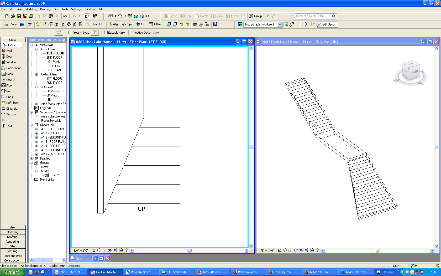

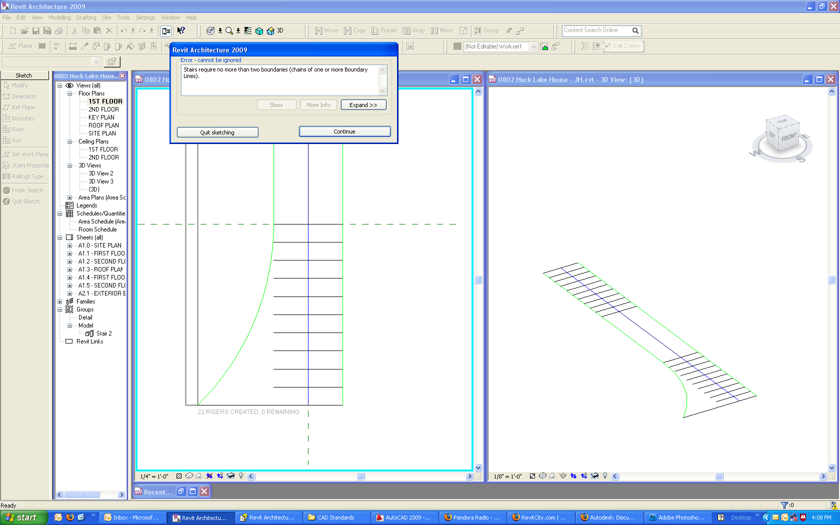

I'm trying to curve the base of the stair, and i keep getting "Stairs require no more than two boundaries (chains of one or more Boundary Lines).
The curve is a single line, and i'm maintaining a split boundary
any help would be much appreciate
 thanks.

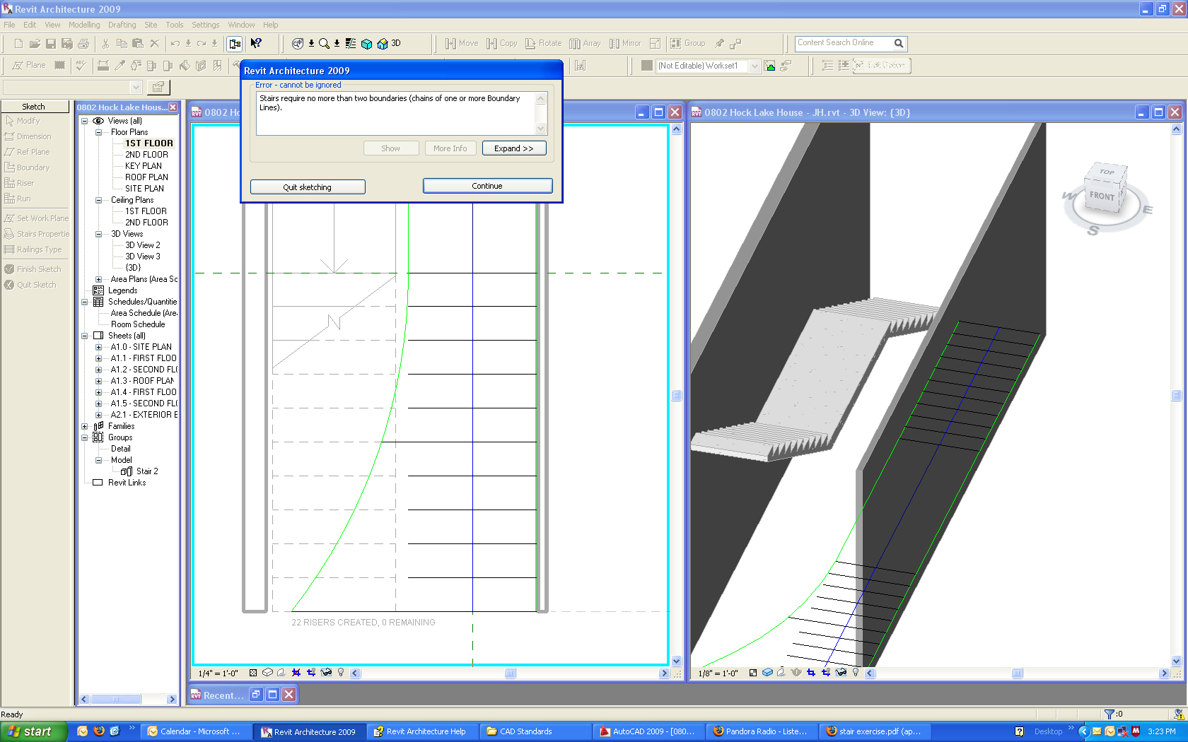

i attached the risers and i still got the same error. i'm not quite sure what it means.
Thu, May 21, 2009 at 3:01:01 PM | Stairs Require no more than two boundaries...
Joined: Tue, May 22, 2007
5921 Posts
4 Stars: 205 Votes

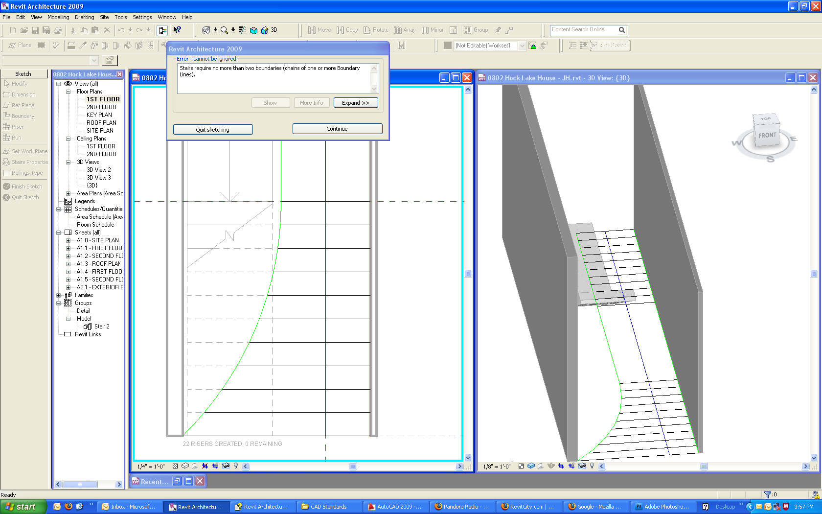

I think you have more than two boudaries in that stair, you can (like you can see) create that stair even if you don't "Touch" the risers with the boundary, delete the boudaries and create new ones....
Thu, May 21, 2009 at 3:03:35 PM | Stairs Require no more than two boundaries...
erland73
erland73 Avatar
Joined: Fri, Sep 7, 2007
738 Posts
4.5 Stars: 85 Votes
jimmi, make sure if you don't have one boundery line on top of another.(BTW, sorry for my wrong past post, I couldn't delete it completly.....)

jimmi163
Joined: Mon, Feb 2, 2009
4 Posts
hey thanks for tyring to help me guys.

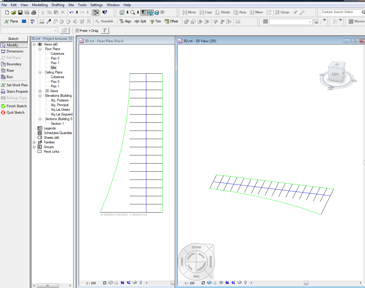

so i went back remade the stair. it works
then i took the boundary line and made the base flare out at the bottom.. works

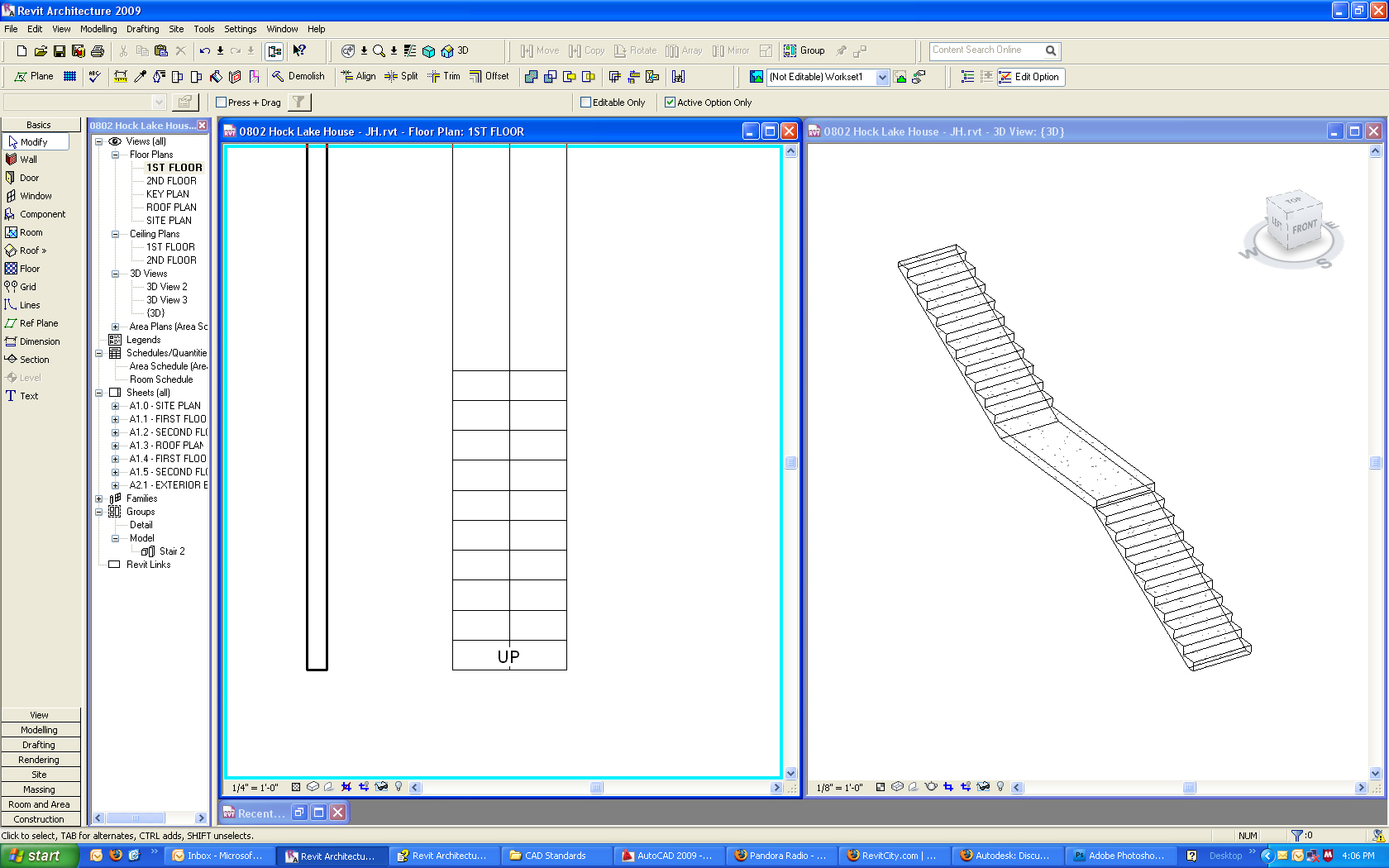

 then i deleted the boundary line and replaced it with a 3 point arch... same error. is there some sort of conecction i should be paying attention to when i draw the arch?
59576_curve_stair_issue-step1.jpg59576_curve_stair_issue-step2.jpg59576_curve_stair_issue-step3.jpg

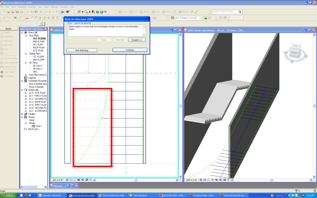

Thu, May 21, 2009 at 3:17:20 PM | Stairs Require no more than two boundaries...
Your risers no longer go to the edge of the boundary.

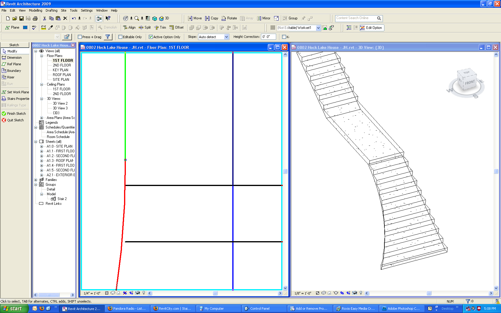

See the video: http://screencast.com/t/KGn7559R
Thu, May 21, 2009 at 4:09:48 PM | Stairs Require no more than two boundaries...
#10
jimmi163
4 Posts
thanks so much that helped a lot.
What i found out was that the arch has to start after the riser.
