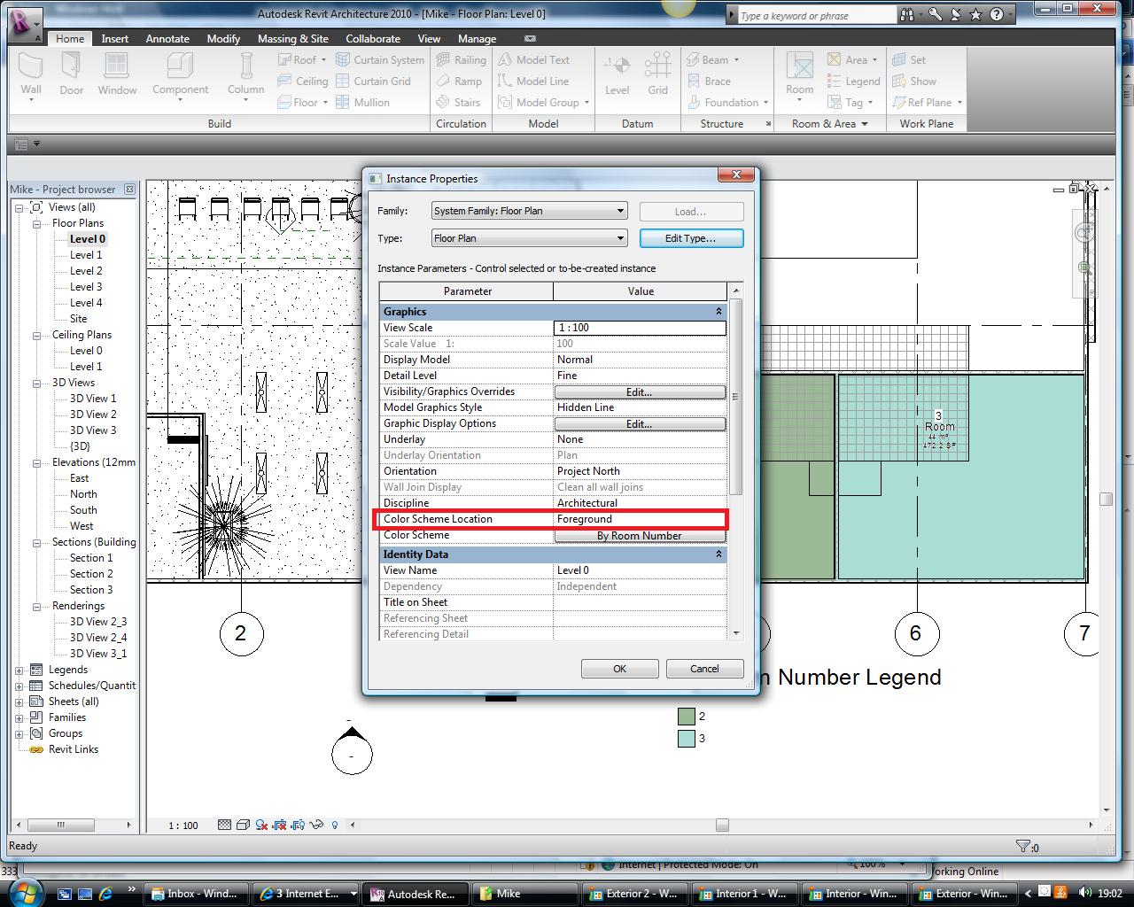

I have my color scheme all set up but once I put a floor slab on top of the old slab it covers up all the room colors.  Is there another way to do this?  I'm trying to make a floor plan where half of the floor is on ground level and the other half is 6" above.  I can only get the room colors to stay where the ground level slab is exposed.  Any ideas?

In the view properties you can set the color scheme to foreground.
