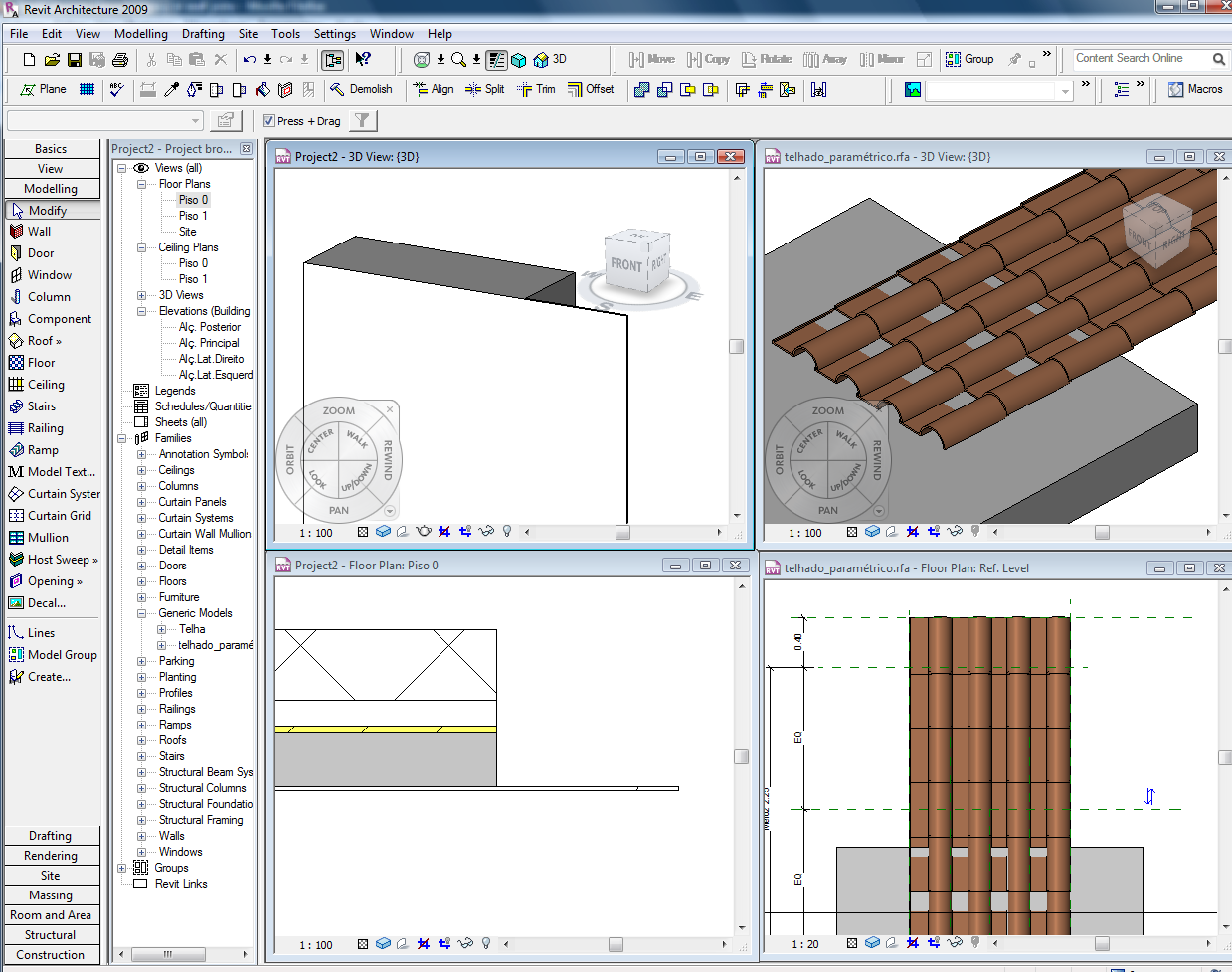

the image you posted is exactly what I want.  I've done it before with varying thicknesses, and relationships to the core boundry (same material) and it usually always works.  yet sometimes this seems to happen.  sometimes with two walls, sometimes with a wall and a floor.  frustrating

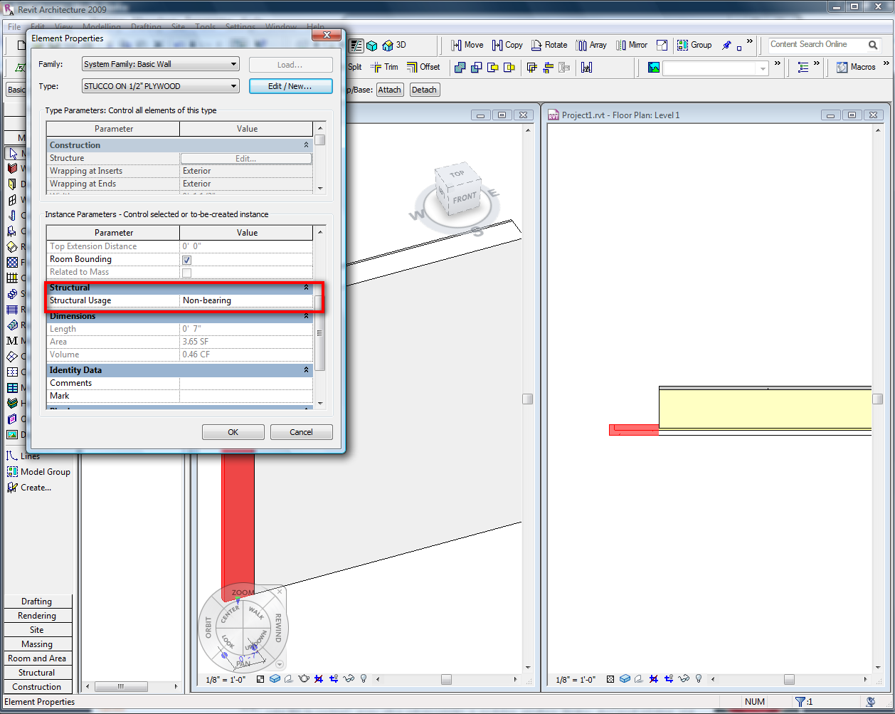

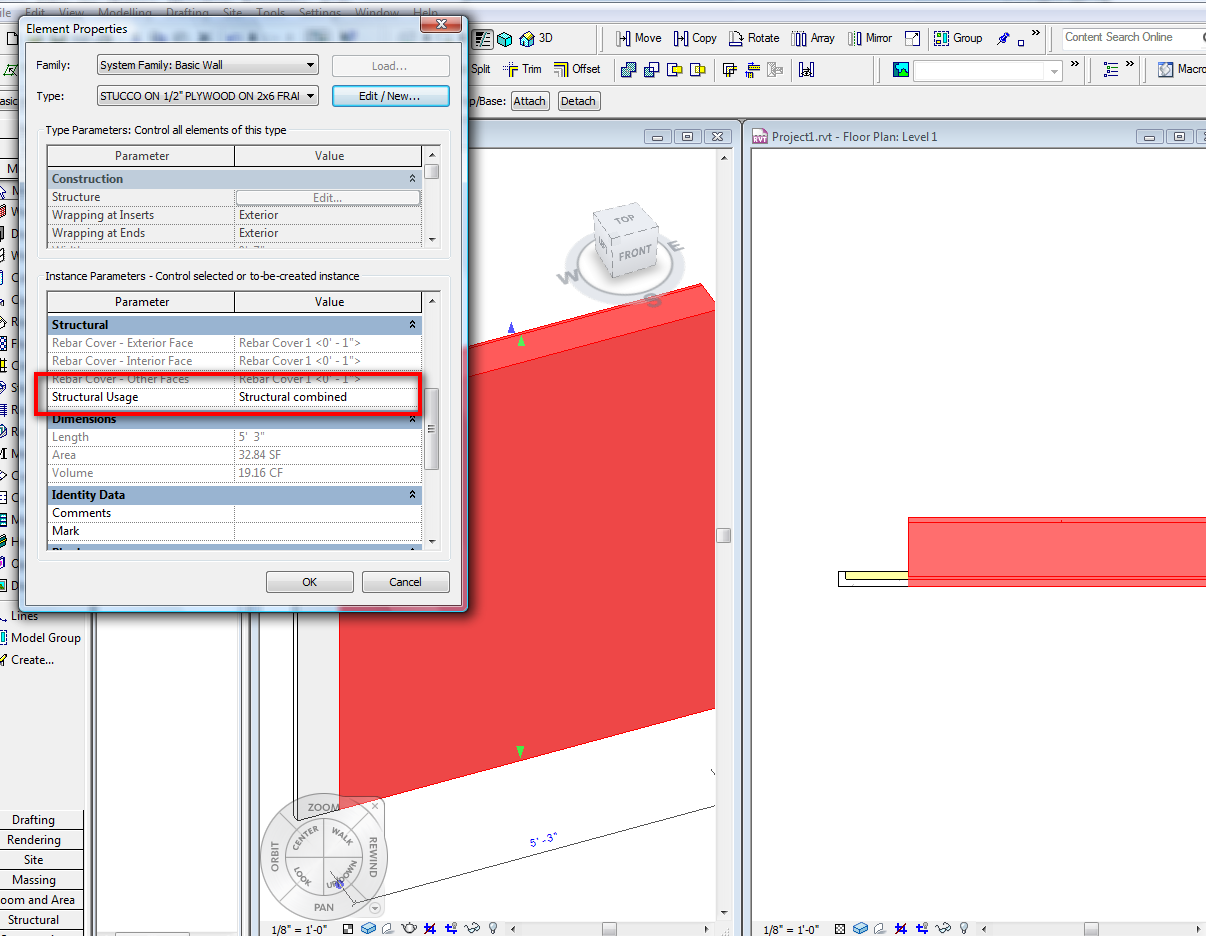

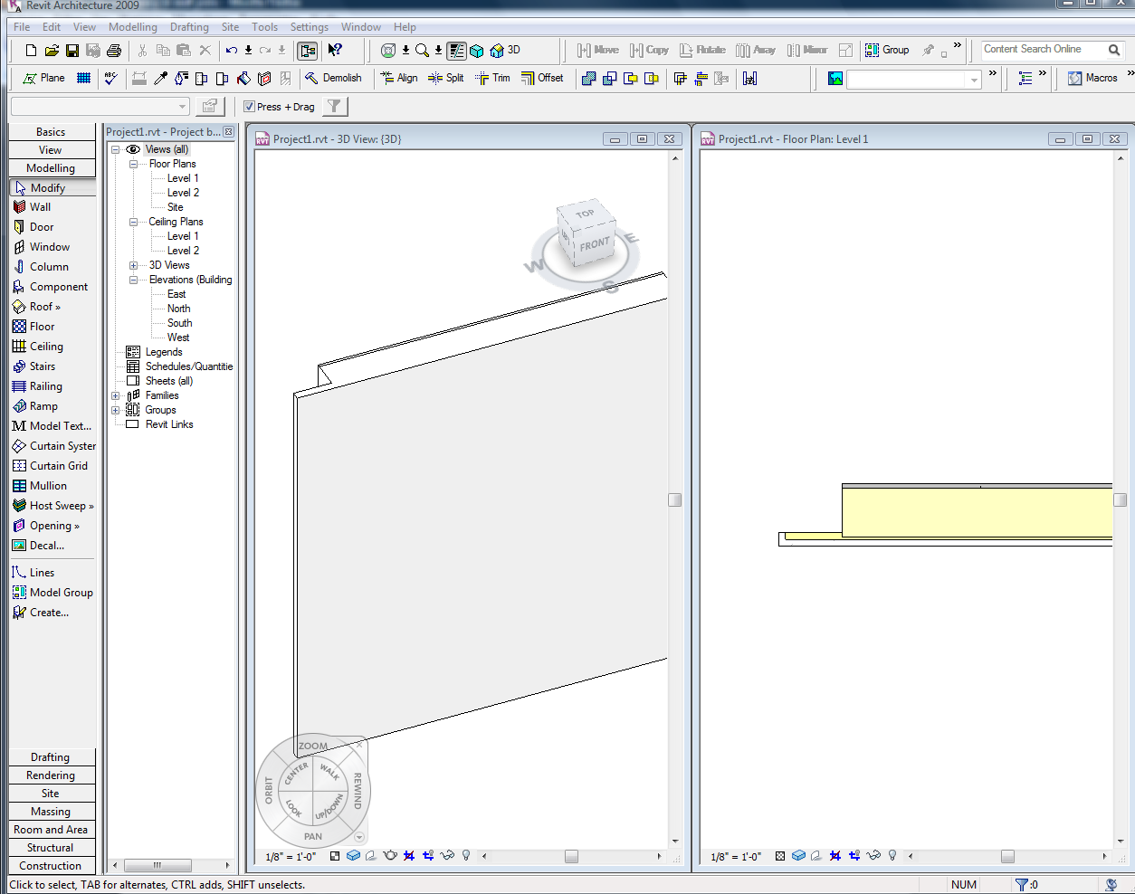

That's the problem "Structural Usage", put in the same Value and problem solved, see the images....
