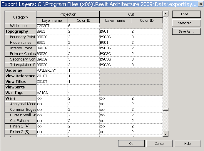

Hi      Does anyone know how to set a export lineweight as 0?      I have problems that my line around the views are exported and I have to manually turn them off.     I have made a screencap of the issue to clarify what i am looking for.       I know i can turn them off but I have the same issues with other element that i dont want to export but often use, like the reference lines.

I don't see how you can set the lineweight to 0.
Our view window exports to a layer that is supposed to be set to no-plot, however, I see that when I open the file, the layer is set to plot though.  I would just set up a script file to run in acad to change that and turn them off.
We  don't have reference lines or reference planes on in our views so that they do not export.

Thanks
Would have been easier if there was a hidden layer export.
I will try to setup the views as finished as possible instead.
