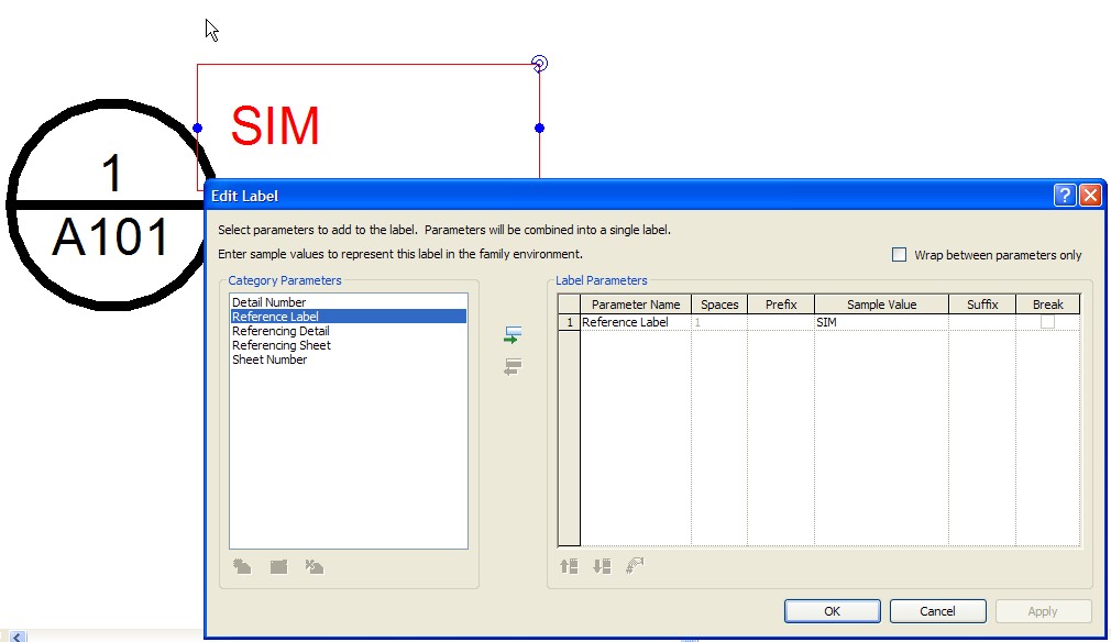

When you edit your normal callout head, it should look like the attached.  Note that "SIM" is a reference as shown it the properties of that label.

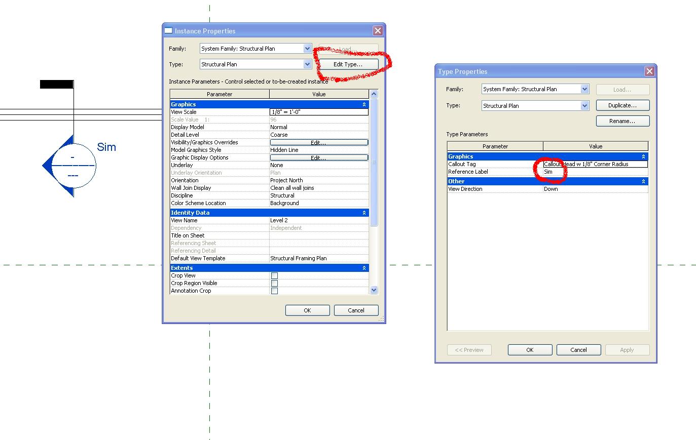

See the attached file...after placing your referenced section marker, right click on it and select view propoerties, then select edit type, then remove where it says "sim"...this will modify all sections of this type and you will not be able to add the SIM or TYP unless you do that with another type or by adding a piece of text.
Hope this helps...

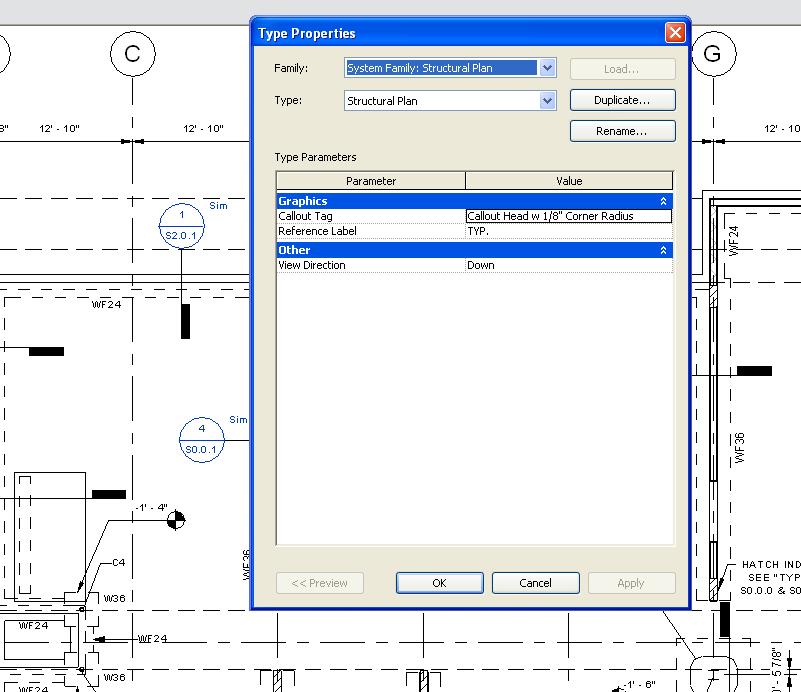

Take a look below.  I assume that when I change the Reference Label location to TYP. that they would all change.  But nothing happens when I place this and hit ok....Could this be a family issue?  This is driving me crazy!

I FIGURED IT OUT!!!!!!!  Crazy enough....it is done as discussed above BUT when my Revit installed all of my family information installed "READ ONLY".  You have to go and make that a non-read only file.  WOOOOAHHH!  Way to many hours trying to figure this out!  Thanks pdoug for your help!

Sorry about that - I just checked it out and your right, the information I gave you doesn't override it.  It used to.  Maybe since 2010 something happened (i don't know).  Anyway, it's a label entity in the callout head family you section is using.  You can go to Manage>Settings>Callout Tags...this will let you know which callout head family you are using.  Then in your project browser you can find the family and edit it.  I would delete the label or edit the label and change the sample value.
