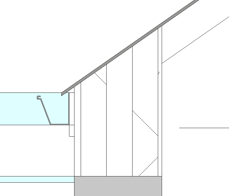

If you draw a section does it look like this, or does the wall extend to the top of the layer?

I hope you still there (I mean after the weekend), Yes the wall extend to the top of the layer.

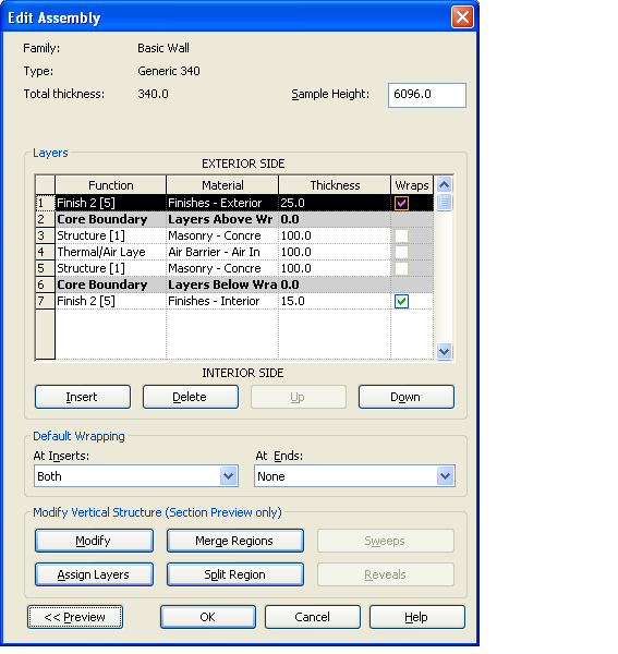

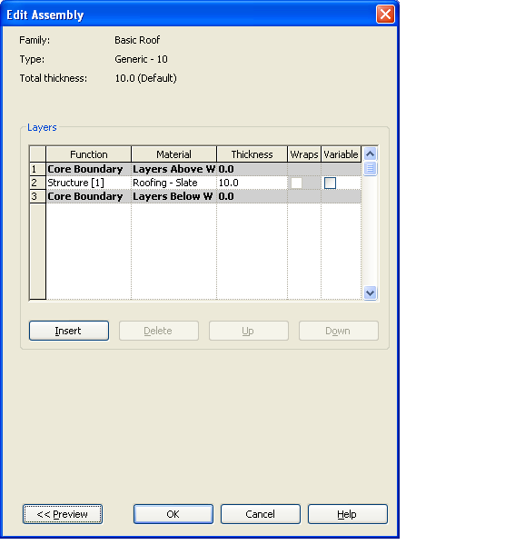

Hi tim123
If you still have energy for that? Have a look at the attached files showing the problem and the construction of the wall and the roof. I think the priority is ok but still have problem.

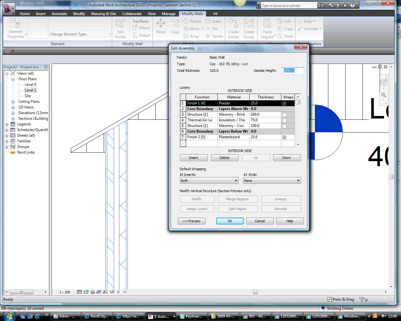

I gave creaeted a similar setup to what you have, the roof is also similar.  This seems to work.  I do notice that when I zoom out I can see the wall lines through the thin roof, but these do not print and dissappear when I zoom in closer.

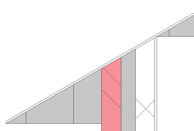

Attached the image.

The roof looks fine - the only thing that I can think of is a view is set to wire frame, or the roof material has some transparancy.
