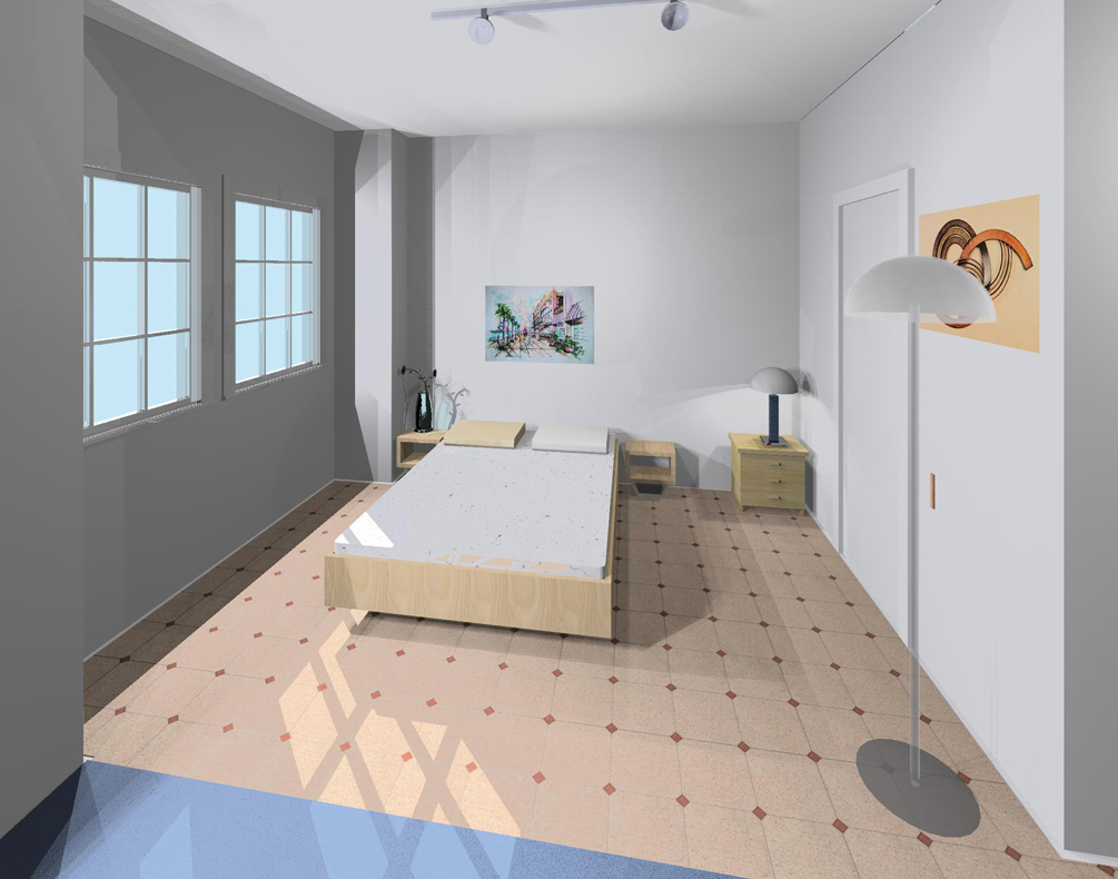

I already have several views of my Revit Project. I would like to drag a view onto a title sheet. This view should
be at the above scale. I made the view black/selected and right clicked. From there I created template view and went
into the dialog box. Under custom scale I chose the desire scale and hit ok. I also "applied" the template from the
drop down view menu and from the dialog box. When I go to the sheet with the views they do not appear to have
changed in size. Frustrating.Could some kind person walk me through the steps. Maybe I am doing it wrong or not
doing something. I need only a B&W view.  Attached is the view, it came out nice at 100dpi. At a later date I would be
nice to know how to install and utilize a HDR file from accustudio. This would preclude me from experimently with
studio and daylights. My first priority is getting a scaled view. Thanks and desperate
Fri, May 15, 2009 at 10:40:20 AM | How do you create a 1"/2 = 1' scaled view ? I'm lost.
View scales are set in the view.  You can do that seperately in the view or after the view is on the sheet.
  1. To change on the sheet - click on the view, activate it (same as being in the view) and at the bottom of the view, you will see the current sclae.  Click on that and change it.
  2. Or while on the sheet, click on the view, right click and in it's element properties, change the scale there.
