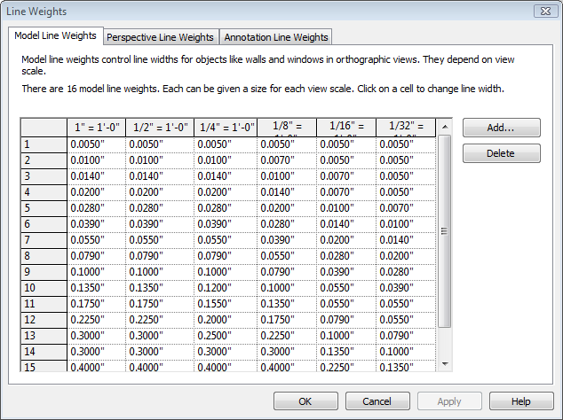

Anyone willing to share successes with lineweights.  We only really need the first 7 pens out of the 16.  The problem is everything looks really heavy especially when two lines are close together.  Any help/screenshots would be great, thanks.

ive tried a few different setups.... this setup is aligned with the national cad standard and my linetypes are extra fine, fine, thin, medium, wide, x wide. xx wide, xxx wide

Well it took us about all of last Summer to decide upon our Pen Standard (YES it was a decision by Committe). Basically we set-up all 16 pens at all scales (not just OOTB scales) ar per the old Tech pen widths. We use basically the first 6 or 7, but we have need of heavier pens closer to #16, thinest is #1 to fatest #16.
Works well when we finally figured out how the pen weight related to Line Style & Object weight.
Sorry our pen table is to big for a screen capture.
