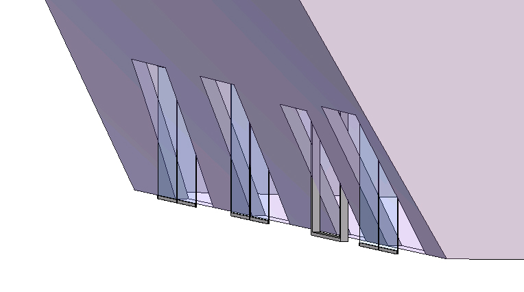

Hi         I got an angled wall and would like to insert a door family that is following the angle of the wall. Could anyone advise what template to use?      I have tried to click off the "always vertical" parameter and also tried to create the door family in a  "generic wall based" template.      thanks

I'm not sure what you mean by "angled wall". Do you have a screenshot of your wall?

Thanks , I mean that the wall has an inclination that the door need to follow.

Between you and I, I don't think you would want an inclined door there. Think of how would you open it to outside if it's a swing door. If it's a sliding-pocket door, that could be tricky, too and very unique.

You must create those doors in a "Generic Model Face Based" family then your door are follow the inclination of the walls....

Thanks for the " Generic Model Face Based" and yes it is a unique solution.
