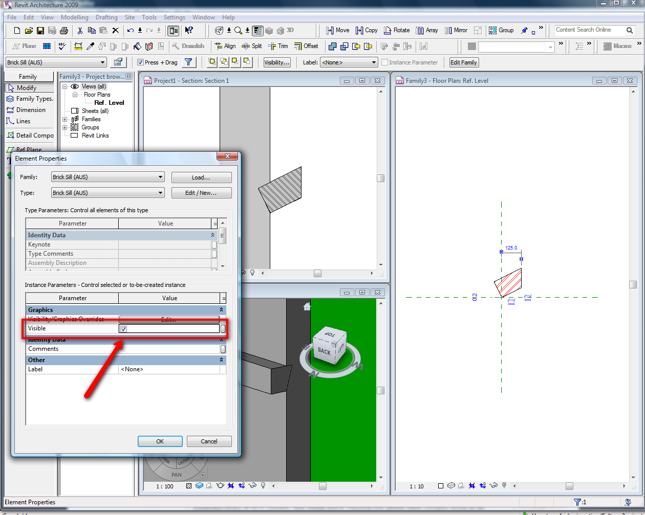

I am trying to add a wall sweep with a 2D detail component in revit structure 2009. my sweep is a 2x4 stud with diagonal lines.  i have the 2d component loaded into my profile, and i am able to add the profile sweep to the wall, but the 2d detail component doesnt show up.  i even tried adding the profile wall sweep from this thread, but have gotten the same results: http://www.revitcity.com/forums.php?action=viewthread&thread_id=10321.
My detail setting is set to fine, my scale is set to 3/4", and i am using 'hidden lines.'  my VG settings have detail items on.
any advice?

Did you check (in the family of your profile) in the properties of your 2D component if the "Visibility" is ON??? did you try to change the scale of that section view???

yes, the visibility is set to on and the scale is set appropriately.
