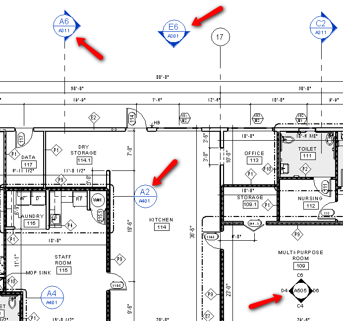

I'm finding that since the elevation tags are uneditable system families, I can't change them to mimick what every office standard I've seen has been, essentially on detail per room (ie 1/A4.01) with four sub details labeled "A", "B", "C" and "D".  I think what Autodesk needs to do is make an entirely new category for interior elevations.  Make a seperate "Legend" type interface in which the user can drop all associated interior elevations from one room into it and then place that on a sheet as a group.  The Callout on the sheet should then look like a combination of the Section Head and the Elevation Tag.  With the interior portion calling out the view reference and sheet number( The 1/A4.01), while the elevation tags at the end of each arrow would reference the individual sub views (the A,B,C and D).

Is this what you mean?

My Blog explains how to achieve what mhans shows.  But yes it is a long standing wishlist item.  Since v3/4 ish!
