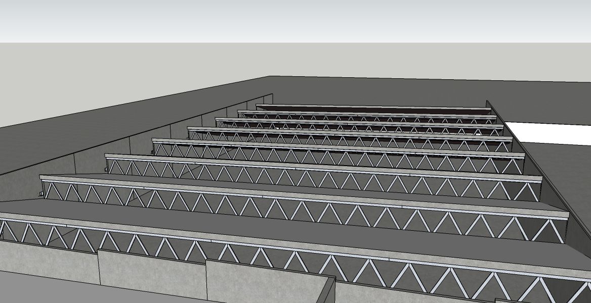

I am trying to slope a flat roof in 2 directions... The roof is a single plane, sloped 3/12 in one direction and then the whole thing is sloped .25/12 in a perpendicular direction. I've tried defining the slope in 2 directions and it gives me a ridge... I've tried the slope arrow - and while I can get it to slope in 2 directions with that, I can't get the slopes that I am desiring because of the lack of control over it. Anybody have any ideas?
I am using revit 2009.
Here's a .jpg of the roof from SketchUp...

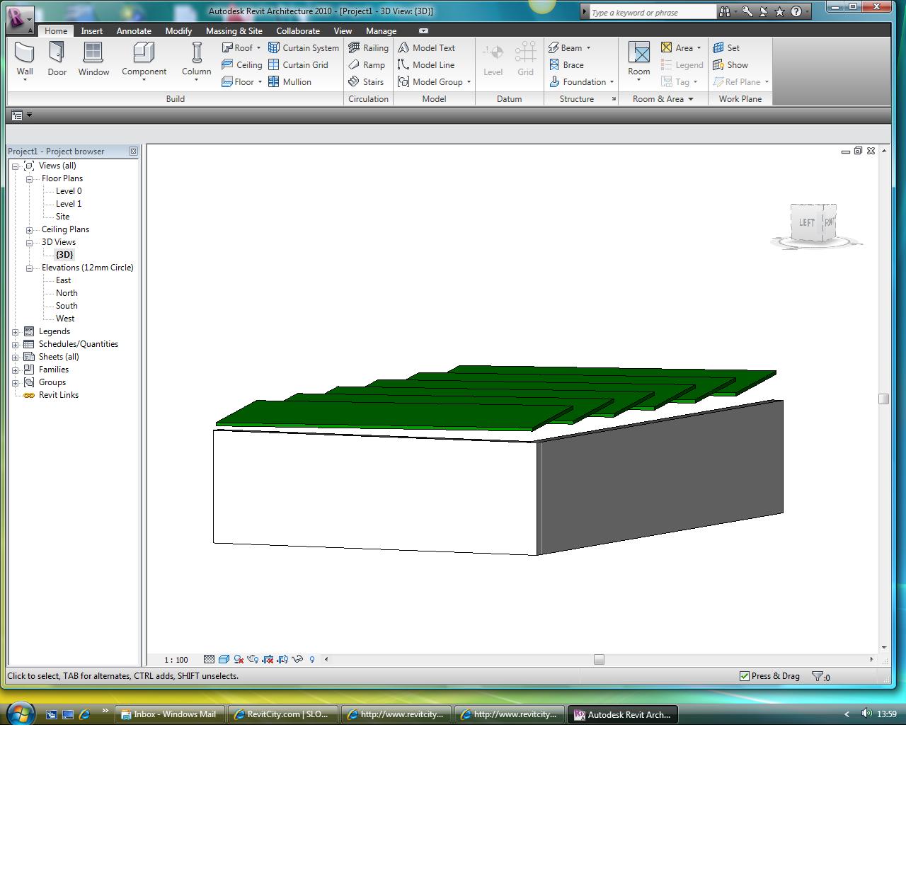

One way to achieve this is to model the roof as a blend, as an in-place family in the roof category.
Sat, May 9, 2009 at 9:09:38 AM | SLOPED FLAT ROOF
Joined: Tue, May 22, 2007
5921 Posts
4 Stars: 205 Votes
Yeah, Tim is right, follow the advise....
