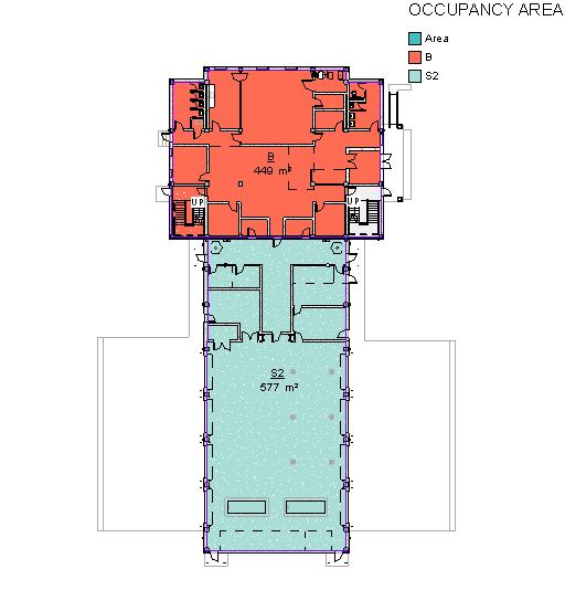

I am struggling with these color schemes. I would like to have the Area of the rooms show up in the legend of the attached image. This is a simple little code plan that shows the mix used occupancy of a building. It would be nice if the tone also went into the stair area in the lower left corner. I have read and re-read the darn help file in Revit, but alas I am not getting it. Any help would be greatly appreciated.

Simply edit your area sketch to include the stair.

Area sketch does include the stair.

Revit only knows what you tell it.   For areas, it uses the area boundry lines - not the model.   If there are area lines outside your stair then you also have area lines between your stair and the red area.  Remove those.

Thats what I kept thinking too. The answer is really kinda strange (at least this fixed the problem).
That area where the tone or shade did not appear had a concrete floor with a solid fill surface pattern. When I change it to be a concrete surface pattern, the area fill worked fine.
Now if I can just figure out these darn legends. I am trying to make a couple of Life Safety plans that show areas, and I am trying to get the Area to show in the legend along with the name.
