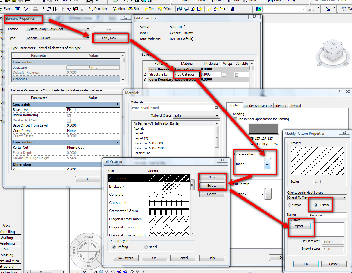

So i am working on this site at 1/60th inch, i want to hatch a small portion of a building roof.  Right now the hatch pattern is much too large, is there any way to scale just the hatch without changing my drawing scale?

You need a new hatch.  If you have the old hatch file (pat) file, re-import it at a new scale.

how do i go about doing that

Go to the materials or properties of that roof and follow the image attached....
