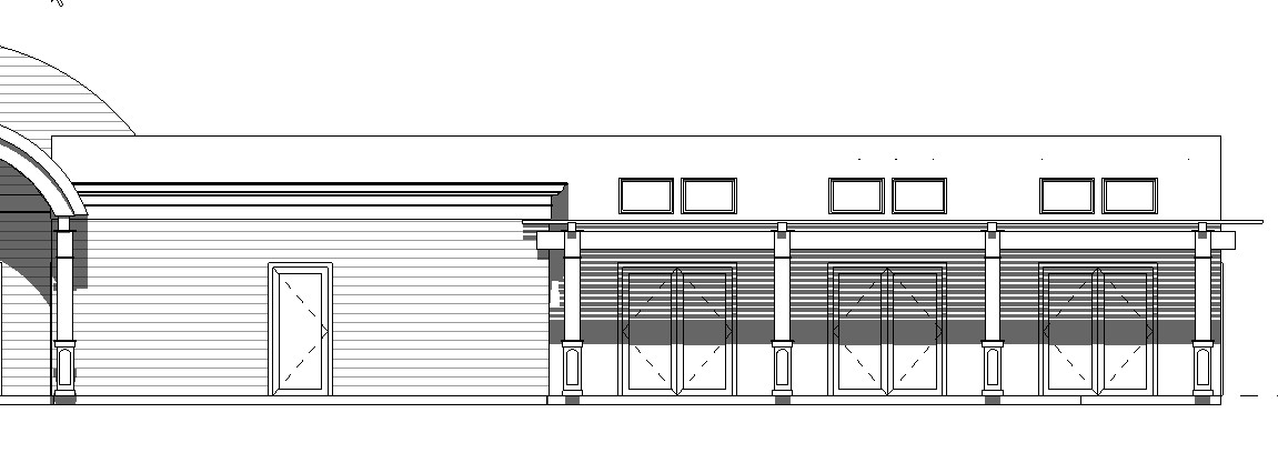

I would like to add a new clapboard finish to an existing cmu wall, and still maintain the integrity of the existing conditions drawing.
If I put a new wall attached to the existing wall will it cut out for windows? Is there another way?
Thu, May 7, 2009 at 10:37:28 AM | new wall finish over existing wall
tim123
Joined: Tue, Apr 12, 2005
1310 Posts
4 Stars: 19 Votes
If you create a new wall just for the clapboard you can join geometry and the wall will act as one.
Thu, May 7, 2009 at 10:46:37 AM | new wall finish over existing wall
Studioe
Joined: Mon, Dec 8, 2008
54 Posts
Oh my god, that's awesome...and right under my nose.
thanks!
