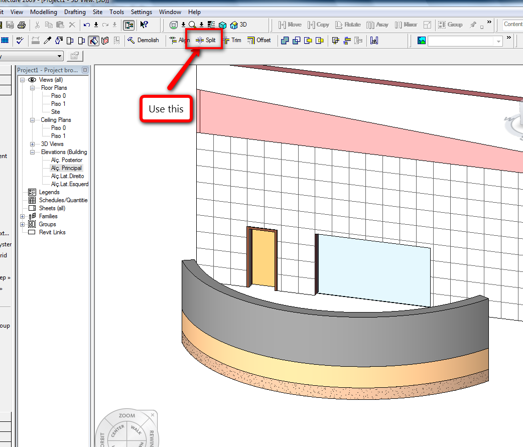

Use this split....
Wed, May 6, 2009 at 3:35:13 PM | Using Split Face
Wolfmann16
Joined: Tue, Sep 25, 2007
38 Posts
That worked.  Thanks!
