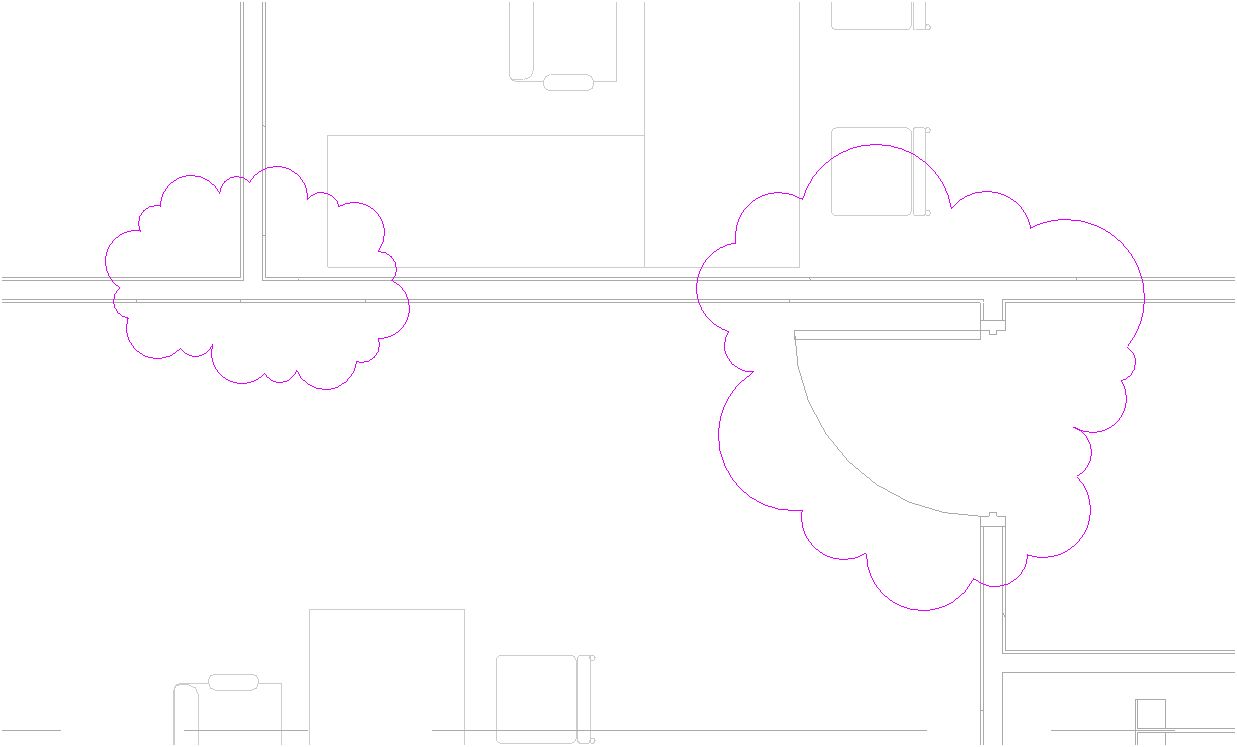

I don't know anyone that wants equal segments - clouds are supposed to be random so that they stand out.  Clouds just mimic what we did with a pencil when we hand drafted and that was a free-hand element - no perfection here!
The cloud is a repeating element.   Just point and click as you go around in a clockwise direction and let them adjust to the spacing of your clicks.

Well now you do.  If it's not a big deal, then why is it used in ADT?  There is a visual difference between the two (attached) and when they are on the same page next to each other it looks sloppy.  Just like everything else in this program it's about consistency.

It doesn't help with the segment length (and with just a little care and practice you can get them close enough), but something I used to to do was trace where I wanted the cloud to be using detail lines, then snap to them with the cloud tool. The segments are all slightly different lengths, the the lines are straight and a bit neater looking.
