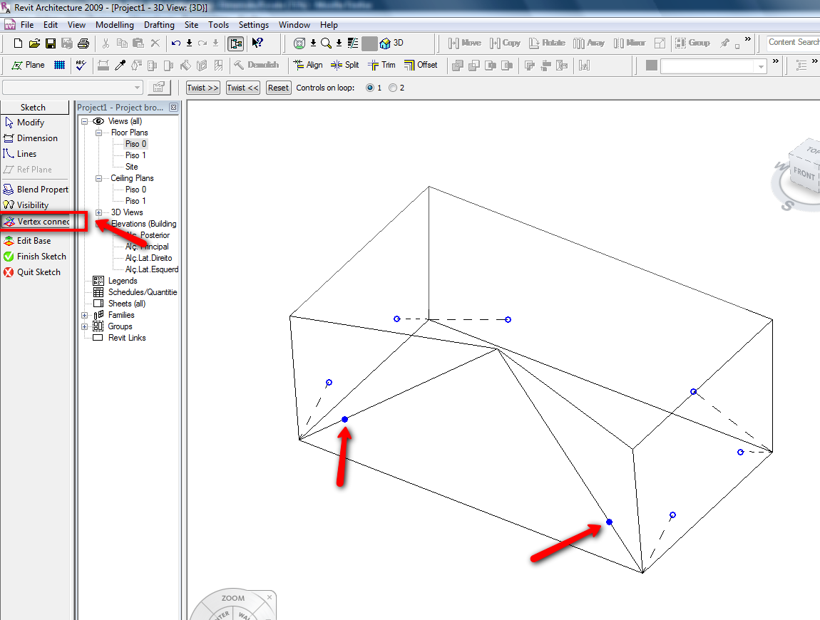

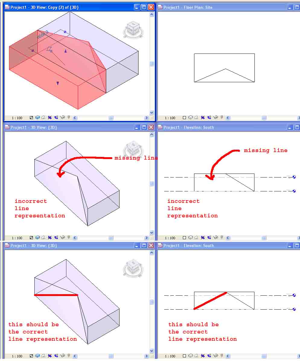

Hello,
A cube mass I created with void blend on one side with triangular form on the half top of it and then meeting at a point down below on the middle of the edge. Upon cutting it with void blend, the graphical representation in incorrect. so even the one side of plane of the mass is incorrect. any help.

May I ask why don't you create a solid blend instead a solid extrusion then use the void????

Thank you typhoon,
A solid blend is ideal, but i am creating a massing study for a faceted facade for a 16K s.m. gfa building. with several options in mind as to how would the different angular cut  could be made when put into actual documentation.  I try the void blend in order to immediately remove that particular void in any case it doesn't fit the design and back to its original basic form.
