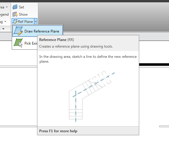

Ok, so I'm having problems with my custom keyboard shortcuts activating the tools.  I'm wasting time trying to figure out where the reference plane button is, yet I know the keyboard shortcut.  So I finally find the tool button and look at it, it says: (RR) next to the Reference Plane.  But when I press RR it doesn't work.  That's the shortcut I set up in this new keyboard shortcuts file.  Anyone know why I'm having issues?
I've attached a screenshot and my shortcuts.
Thanks,
Lorne

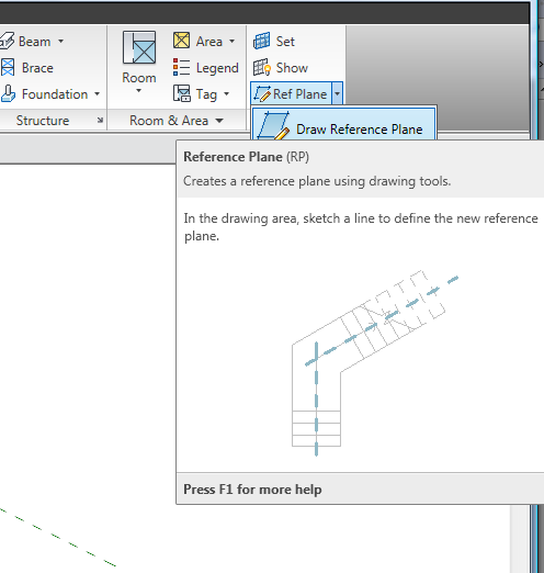

Reference Plane= RP
Edited on: Tue, May 5, 2009 at 12:53:07 PM
Tue, May 5, 2009 at 1:00:19 PM | Some Keyboard shortcuts not working?
Joined: Tue, May 22, 2007
5921 Posts
4 Stars: 205 Votes
That's why....

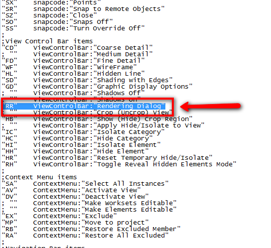

I searched for 'RR' in your file and found that it is also used for another command -
"RR"    ViewControlBar:"Rendering Dialog" .
That is the reason it is not working.  When you make custon shortcuts, it is a good idea to run a search for the shortcut to make sure it is not already taken.

Oh dang it.  Now I'm embarrased.  I should have thought of that.  Thanks for the help, it's always something simple! Smile
Lorne
