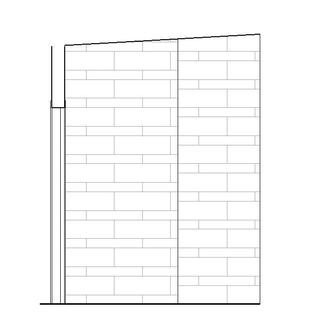

i have created a custom fill pattern and applied it to a custom wall type, but when two of these walls appear together in elevation, the pattern does not align.  both walls are base constrained to the same level and attach to a sloping ceiling above.  see attached elevation.  any ideas how to align the pattern?

Assuming that it's a model pattern, you can select a line in the pattern (use the tab key) and move or align or rotate it.

Thanks everyone. Tim's suggestion worked perfectly.  I'll check out the align option and other link.
