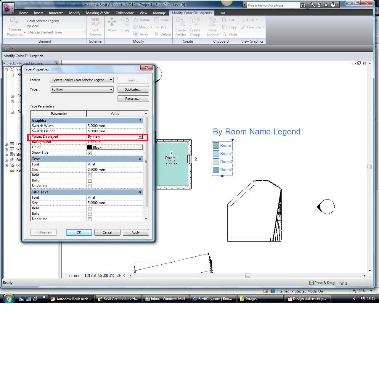

Hi,
In my project I have two levels, first and second floor.At this time, when I create a legend for the rooms, I can see all the rooms from the second floor in the room legend from the first floor and vice versa.
Is it possible to create a legend that listst only the rooms from the current level you see in floorplan?
Thanks for any help!
Peter
Sun, May 3, 2009 at 7:53:02 AM | Rooms: how to create a legend for only one floor?
tim123
Joined: Tue, Apr 12, 2005
1310 Posts
4 Stars: 19 Votes
If you go into the properties of the legend you have the option to set the values displayed to 'By view' or 'All'.
Sun, May 3, 2009 at 3:21:52 PM | Rooms: how to create a legend for only one floor?
petergeraerts
Joined: Tue, Jan 27, 2009
3 Posts
Thanks!  Completely overlooked that one!
